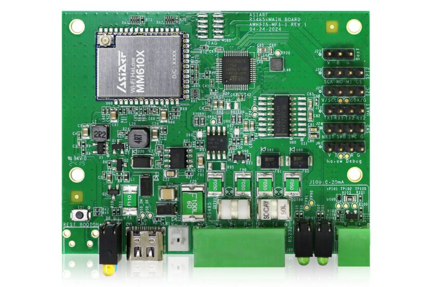

AsiaRF AWH575-MF1 Wi-Fi HaLow module specifications:
  • MCU: STMicroelectronics STM32U585CIT6Q
    • Core: 32-bit Arm Cortex-M33 core @ 160 MHz
    • Memory: 786 KB SRAM
    • Storage: 2MB
  • Wi-Fi HaLow (IEEE 802.11ah):
    • Chipset: Morse Micro MM6108
    • Frequency: 902 MHz to 928 MHz
    • Channel Bandwidths: 1 / 2 / 4 / 8 MHz
    • Modulation: BPSK, QPSK, 16-QAM, 64-QAM
    • Data Rate: Up to 10 Mbps (single-stream)
    • Transmit Power: 21 dBm ±2 dBm @ MCS 0
    • Range: Up to 1 km (line-of-sight)
    • Antenna: Dipole antenna via IPEX connector
    • Security: AES encryption engine, SHA-256/SHA-384/SHA-512 hardware support, WPA3, PMF, Opportunistic Wireless Encryption (OWE)
  • Interfaces:
    • SPI: 4-pin header, supports simplex, half/full-duplex
    • I2C: 4-pin header, up to 100 kbps (standard), 400 kbps (fast mode)
    • UART: 4-pin header for UART1 and UART2
    • RS-485:
      • Terminal block connector, Data+, Data−
      • Baud rate: 50 bps to 9.6 Mbps
      • Protocols: Modbus RTU, Modbus ASCII
    • RS-232:
      • Baud rate: Up to 921.6 kbps
    • ADC:
      • 12-bit resolution
      • Sampling rate: Up to 2.75 Msps
  • Debug: SWD (Serial-Wire Debug) header, HaLow debug header
  • Misc:
    • LED Indicators:
      • Power (Blue)
      • Wi-Fi HaLow Link (Orange)
      • RS-485 Tx (Green), Rx (Yellow)
      • RS-232 Tx (Green), Rx (Yellow)
    • Button: Reset button
  • Power Supply:
    • Input Voltage:
      • 5V DC @ 2A via USB Type-C
      • 9–24V DC via terminal block (optional)
      • Power Consumption: Max 10W
  • Dimensions: 76 x 60 mm
  • Weight: 300 grams

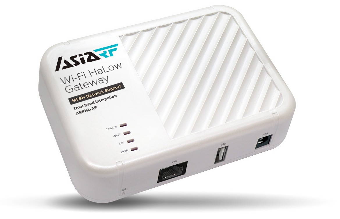

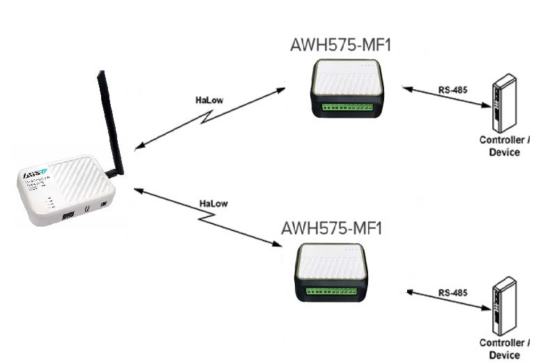

The image above shows multiple AWH575-MF1 IoT controllers connected to AsiaRF’s Wi-Fi HaLow MESH Gateway (ARFHL-AP-MS01). This dual-band gateway supports both 2.4GHz and sub-GHz HaLow frequencies, enabling robust and scalable mesh networking for industrial IoT (IIoT) deployments.
Wi-Fi HaLow gateway
Wi-Fi HaLow gateway
The AWH575-MF1 Wi-Fi HaLow module is available for $99 and includes a 900MHz 2.5dBi antenna and a 100mm SMA female to IPEX pigtail cable. The Wi-Fi HaLow MESH Gateway, bundled with an antenna and power adapter, is available for $168.
