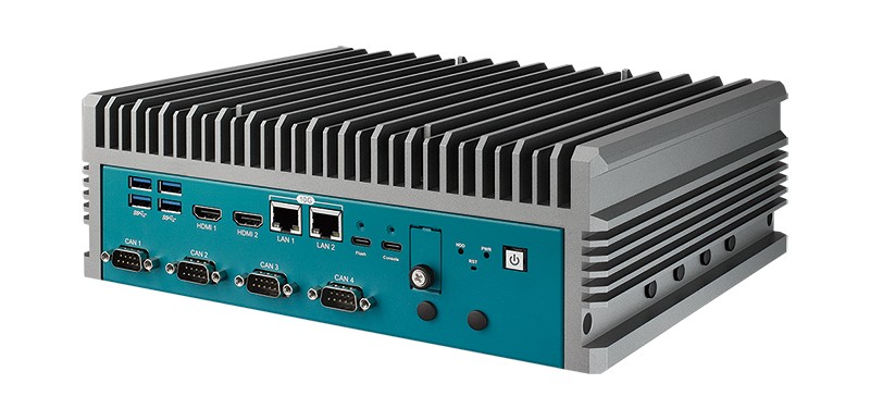

Vecow EAC-7000 series embedded systems

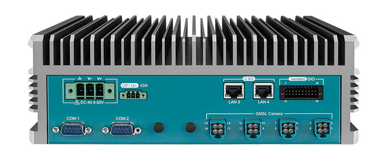

Vecow EAC-7000 series embedded systems back side

    • EAC-7100: 8x Fakra-Z — GMSL 1 and 2 automotive cameras
    • EAC-7200: 4x mini-Fakra, 16 total lanes
  • I/O connectivity:
    • 4x USB 3.1 Type-A + 2x USB Type-C (debug + flashing)
    • 2x RS-232/422/485 selectable serial ports
    • 4x isolated CAN-FD + 16x isolated digital I/O (8 DI / 8 DO)
    • 8x antenna cutouts — 5G / LTE / Wi-Fi 7 / LoRa / GNSS

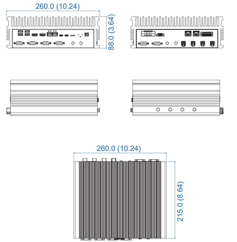

    • 260 x 215 x 88 mm metal enclosure (wall-mount)
    • weight: 5.5 kg

Dimensions
