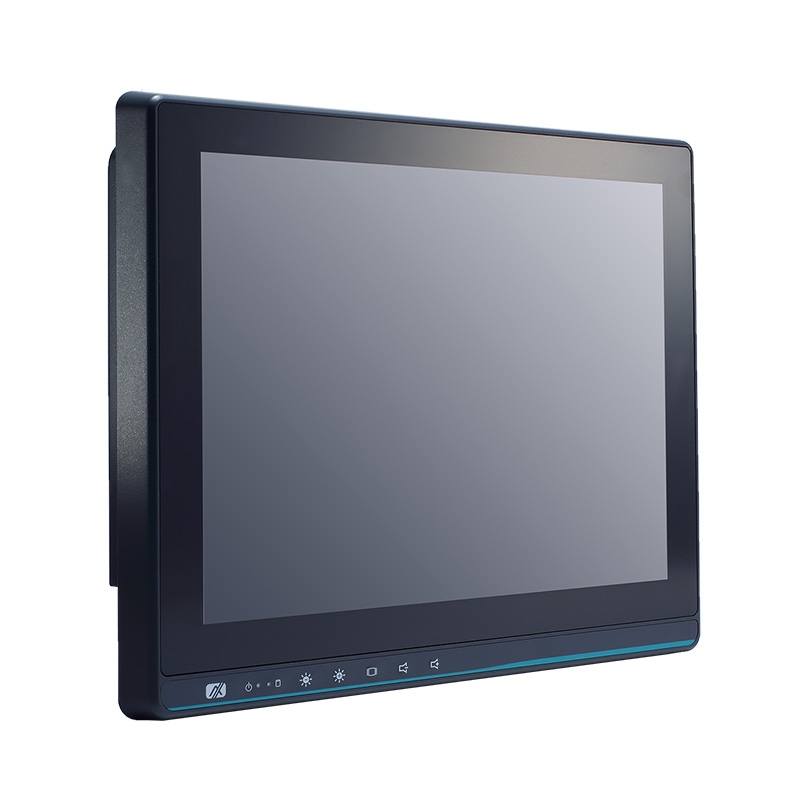

Axiomtek – a world-renowned leader relentlessly devoted in the research, development and manufacture of series of innovative and reliable industrial computer products of high efficiency – is pleased to introduce the GOT115-319, a 15-inch fanless touch panel computer with a thickness of only 50 mm for used in space-constrained environments. It is powered by the Intel® Celeron® processor N3350 or Intel® Pentium® processor N4200 with the Intel® GFX controller onboard. The GOT115-319 has a 15-inch XGA TFT LCD display with a projected capacitive multi-touch or resistive touch optional touchscreen, 300 nits of brightness and LED backlight. It is a cost-effective solution to achieve a high degree of stability and adaptability for use in multimedia kiosks or as a human machine interface (HMI) for smart manufacturing and rugged retail fields.
“Axiomtek’s 15” XGA GOT115-319 has 1024 x 768 resolutions. It has five programmable OSD function keys on the front panel for users to easily adjust LCD on/off, brightness and volume. Moreover, this compact touch panel computer offers easy access to storage and RAM,” said Frank Chang, a product manager of Product PM Division at Axiomtek. “The robust industrial touch panel PC GOT115-319 has an ultra-slim housing for use in space-constrained environments. It can operate reliably in harsh environments with its wide operating temperature of 0°C to +50°C and vibration endurance for up to 2G.”
The GOT115-319 features rich I/O connectivity. It is equipped with two GbE LAN ports, two USB 2.0 ports, two USB 3.0 ports, one RS-232 port and one RS-232/422/485 port with RI/5V/12V which is selectable by BIOS and one Line-out. Other features include one power button, one remote power switch and one screw-type connector for power. In addition, there is an easily accessible external switch for AT/ATX mode selection and built-in speakers and microphone for multimedia applications. The GOT115-319 supports one full-size PCI Express Mini Card slot and one M.2 Key E slot for RFID and wireless network module installation. The ultra-slim panel computer is equipped with one 204-pin DDR3L-1600 SO-DIMM with up to 8GB of memory capacity. It also offers one 2.5″ SATA HDD/SSD, one mSATA and one MicroSD card for storage. To meet diverse installation requirements, it supports panel mount, wall mount, VESA arm and desktop stand.
