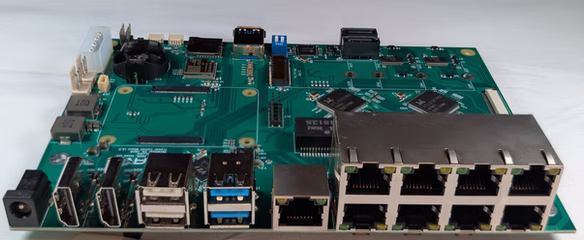

Exaviz has introduced the Cruiser, a high-integration Raspberry Pi Carrier Board built for the Raspberry Pi Compute Module 5 (CM5). Instead of relying on stacked HATs, USB adapters, and external PoE switches, this board consolidates switching, storage, wireless, and display into a single Mini-ITX compatible platform. The design targets NVR deployments, smart home hubs, and edge AI systems that need reliable networking and local storage without extra boxes.
At the hardware level, Cruiser integrates an 8-port Gigabit switch based on the Realtek RTL8367RB and a 2.5GbE WAN uplink through the Realtek RTL8156BG over USB 3.0. PoE models use the TI TPS23861 controller to deliver up to 30W per port under IEEE 802.3at. Exaviz pairs this networking stack with NVMe, dual SATA, dual HDMI, and an onboard ESP32-C6 module, turning the board into a compact all-in-one infrastructure node.
Cruiser Carrier Board v1.0 Ports
Cruiser Carrier Board v1.0 Specification:

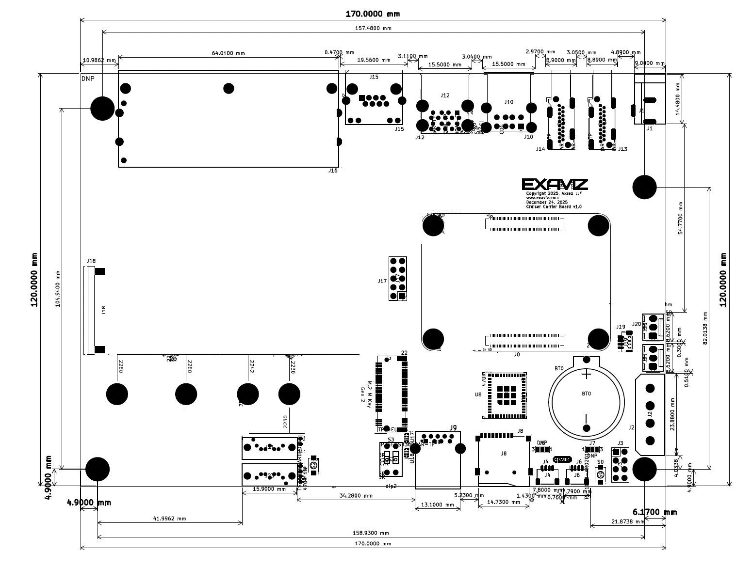

  • Mechanical:
    • Dimensions: 170mm × 120mm (Mini-ITX compatible)
    • Operating temperature: 0°C to +70°C

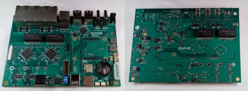

Cruiser Carrier Board v1.0 Top and Bottom Side
Cruiser supports Raspberry Pi OS (64-bit), Debian Trixie, and Ubuntu 25.10 or newer releases. Exaviz provides a Debian-based image with drivers pre-installed through its DKMS package. Users can control PoE per port via /dev/pse, and the company maintains an APT repository for updates. The board also supports Home Assistant through an Exaviz HACS plugin, allowing direct Zigbee coordination without USB dongles.

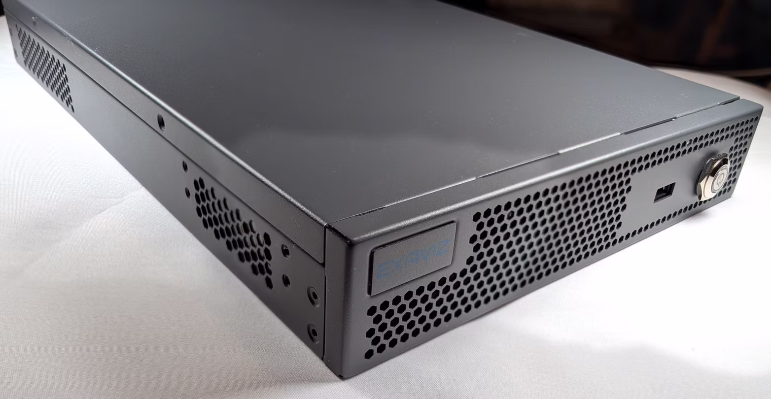

Cruiser Desktop Case

Carrier Board Dimensions
