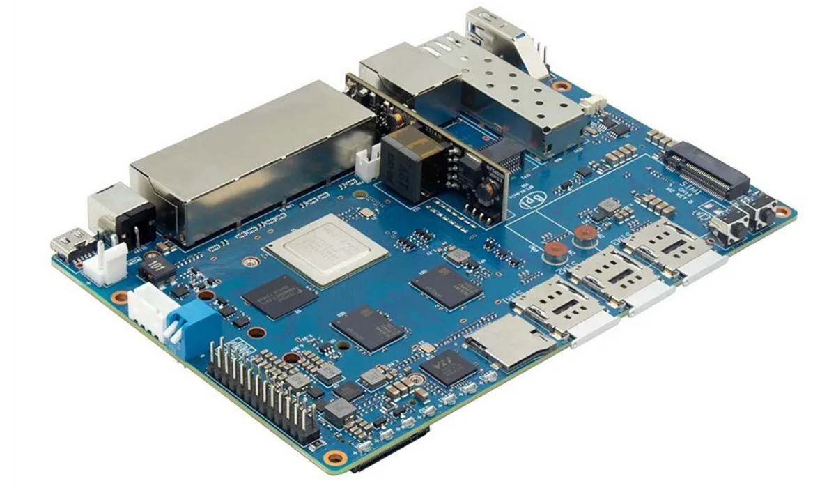

The Banana Pi is working on the BPI-R4 Lite, a cost-effective router board designed for home networking, small offices, and educational projects. It features a MediaTek MT7987A quad-core ARM Cortex-A53 processor, 2GB DDR4 RAM (supports up to 4GB), 8GB eMMC flash, and multiple storage options, including 256MB SPI NAND, 32MB SPI-NOR flash, and a microSD card slot.
The Banana Pi is working on the BPI-R4 Lite, a cost-effective router board designed for home networking, small offices, and educational projects. It features a MediaTek MT7987A quad-core ARM Cortex-A53 processor, 2GB DDR4 RAM (supports up to 4GB), 8GB eMMC flash, and multiple storage options, including 256MB SPI NAND, 32MB SPI-NOR flash, and a microSD card slot. For connectivity, it includes 1x 2.5G SFP, 1x 2.5G RJ45 WAN port (PoE support), 4x 1G LAN ports, 1x USB 3.0 slot, an M.2 Key-B slot for 5G modules, and mini PCIe 3.0 slots for Wi-Fi 7 NICs.
Banana Pi router board
The board supports 2x 8-pin MikroBUS headers, allowing easy expansion for various applications. While it lacks the 10G SFP+ ports and an M.2 NVMe slot found in the standard BPI-R4 model, it remains a solid choice for users needing affordable, open-source networking hardware. The addition of a Type-C UART Debug Console simplifies debugging and recovery, Ideal for OpenWrt-based applications. This board is perfect for custom network infrastructure, IoT projects, and small-scale enterprise setups, offering strong performance at a lower price than its predecessor, the BPI-R4.

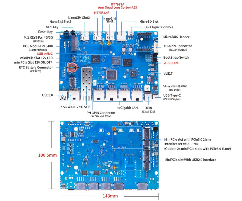

Banana Pi BPI-R4 Lite Router Board Specifications:
  • SoC:
    • MediaTek MT7987A quad-core Arm Cortex-A53 processor
  • Memory:
    • 2GB DDR4 RAM (SoC supports up to 4GB)
  • Storage:
    • 8GB eMMC flash
    • 256MB SPI NAND flash
    • 32MB SPI-NOR flash
    • 1x microSD card slot
  • Networking:
    • 1x 2.5GbE SFP
    • 1x 2.5 GbE RJ45 WAN port (PoE support with optional module)
    • 4x 1GbE RJ45 LAN ports
    • 3x Nano Sim Slot
  • USB:
    • 1x USB 3.0 port
    • 1x USB Type-C Debug Console
  • Expansion:
    • 1x M.2 Key-B slot (USB 3.0) for 5G modem
    • 1x mini PCIe slot (PCIe 3.0 x2) for Wi-Fi 7 NIC (option: 2x mini PCIe with PCIe 3.0 x1)
    • 1x mini PCIe slot (USB 2.0)
    • 2x 8-pin MikroBUS headers
    • XH-4-pin connector (5V/12V output)
  • Misc:
    • mini PCIw slot 12V LED
    • WPS Key
    • Reset key
    • RTC Battery Connector
    • Compact design with optional Wi-Fi 7 NIC expansion
  • Power:
    • 12V DC
    • 20V via Type-C PD Charger
    • mini PCI slot 12V On/Off
  • Dimension: 100.5 x 148mm
