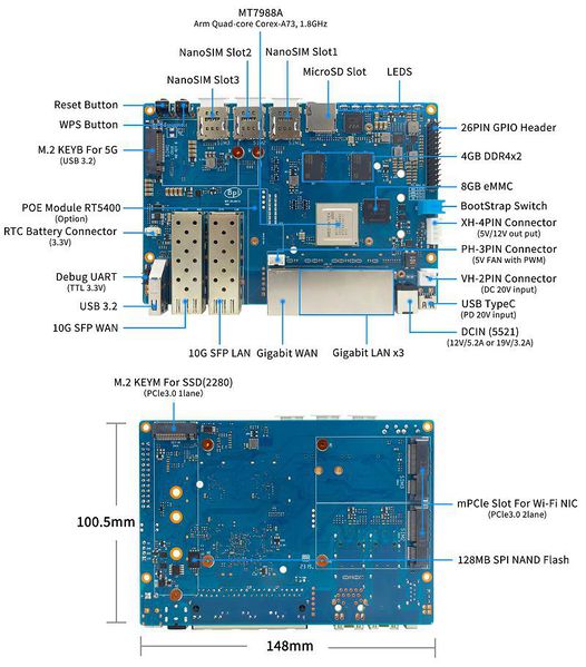

Banana Pi BPI-R4 specifications:
  • SoC: MediaTek MT7988A (Filogic 880) quad-core Arm Cortex-A73 @ 1.8GHz, AI-powered packet accelerator
  • Memory: 4GB DDR4
  • Storage: 8GB eMMC, 128MB SPI NAND Flash, microSD slot, M.2 Key M for NVMe SSD
  • Networking: 2x 10GbE SFP cages (or 1x 10Gbe SFP, 1x 2.5Gbe PHY), 4x Gigabit Ethernet RJ45 (1x WAN, 3x LAN)
  • USB: USB 3.2 port
  • Expansion: M.2 slots for 5G/4G and NVMe SSD, 2x mini PCIe for Wi-Fi 7, 26-pin GPIO header
  • Debugging: 3-pin header for 3.3V serial console
  • Misc: Reset, WPS buttons, bootstrap switch, RTC battery connector
  • Power: 12V/5.2A or 19V/3.2A DC jack, 20V DC input, Optional PoE module
  • Dimensions: 148 x 100.5 mm
  • Weight: 250g

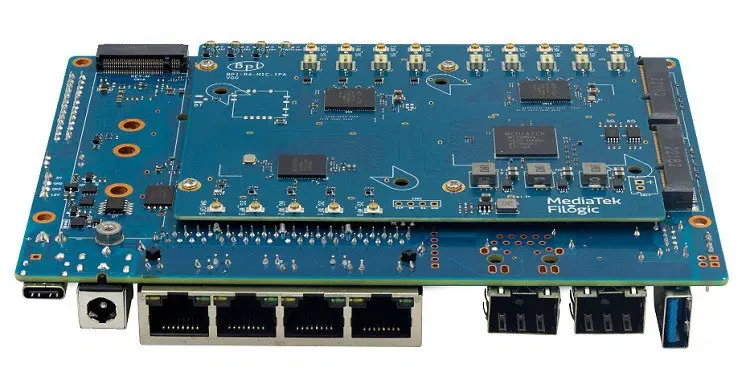

The company will be offering OpenWrt and Debian software for the board, but this is only for ethernet support. The Banana Pi BPI-R4 board doesn’t come with WiFi 7, but you can add it through two mini PCIe sockets as shown in the photo below. More information is available on their wiki, though it lacks software details.
