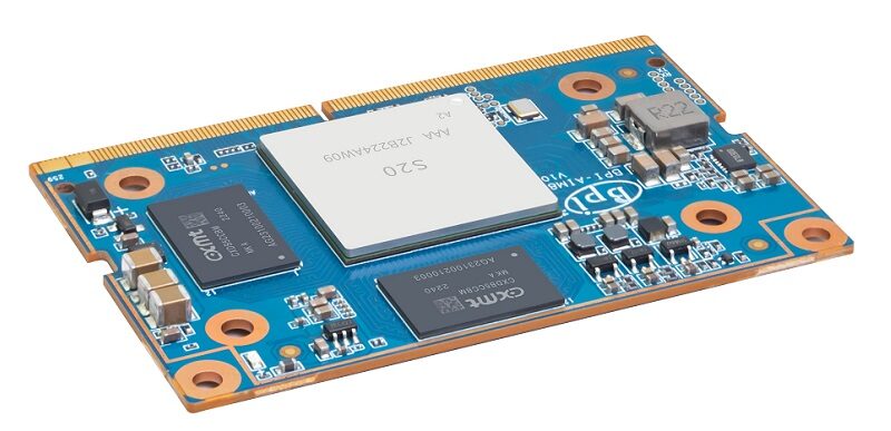

Banana Pi BPI-SM9 Front

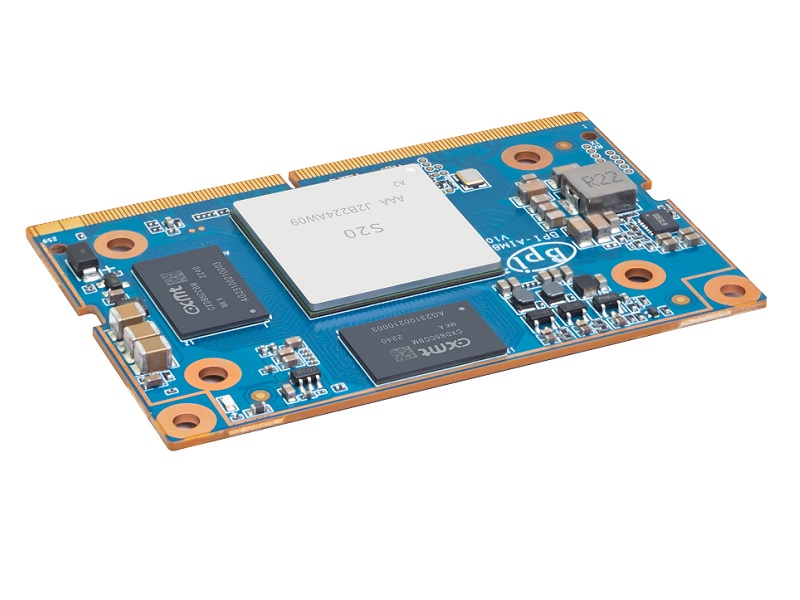

Banana Pi BPI-SM9
The Banana Pi BPI-SM9 appears as the company’s first compute module built around a dedicated AI and vision processor, moving beyond its regular SBC lineup. It focuses on edge-side intelligent computing and supports workloads such as video analytics, computer vision, AI inference, and multimedia tasks in a compact, power-efficient design.
As demand grows for embedded and edge-AI platforms, the BPI-SM9 aims to deliver a balanced mix of performance and flexibility. Developers working on real-time video, object detection, or any AI-driven project can use its combination of a general-purpose CPU, a strong NPU, and a wide set of I/O interfaces to build reliable and fast edge systems.

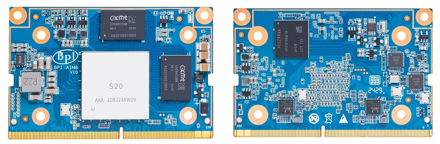

Banana Pi BPI-SM9 top and bottom
Banana Pi BPI-SM9 Compute Module Specifications:
  • SoC/AI Processor: SOPHGO BM1688 with 8x Arm Cortex-A53 cores @ 1.6 GHz and 16 TOPS NPU (INT8), supporting INT4/INT8/FP16/BF16/FP32
  • Memory: 8GB LPDDR4X
  • Storage: 32GB eMMC flash; SD/SDIO support
  • Video:
    • Video Decoder: Up to 16× 1080p60 or multi-format decode up to 8K/4K/1080p/720p
    • Video Encoder: Up to 10× 1080p30 H.264/H.265
  • Display Output: HDMI 2.0 up to 8K
  • Camera Interfaces: Dual MIPI-CSI (up to 8MP ×2)
  • ISP Features: HDR, 3DNR, LDC, dehaze, stereo depth, image stitching, fisheye correction
  • Connectivity: Dual Gigabit Ethernet (through carrier), USB 3.0, USB 2.0
  • Expansion: PCIe 3.0 interface, SATA, multiple UART, I²C, SPI, PWM, ADC, GPIO

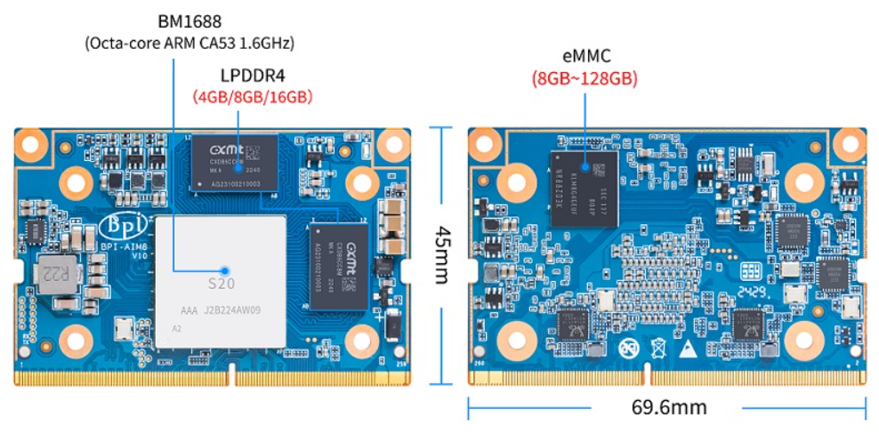

Banana-Pi-BPI-SM9-Dimensions
Banana-Pi-BPI-SM9 Dimensions
