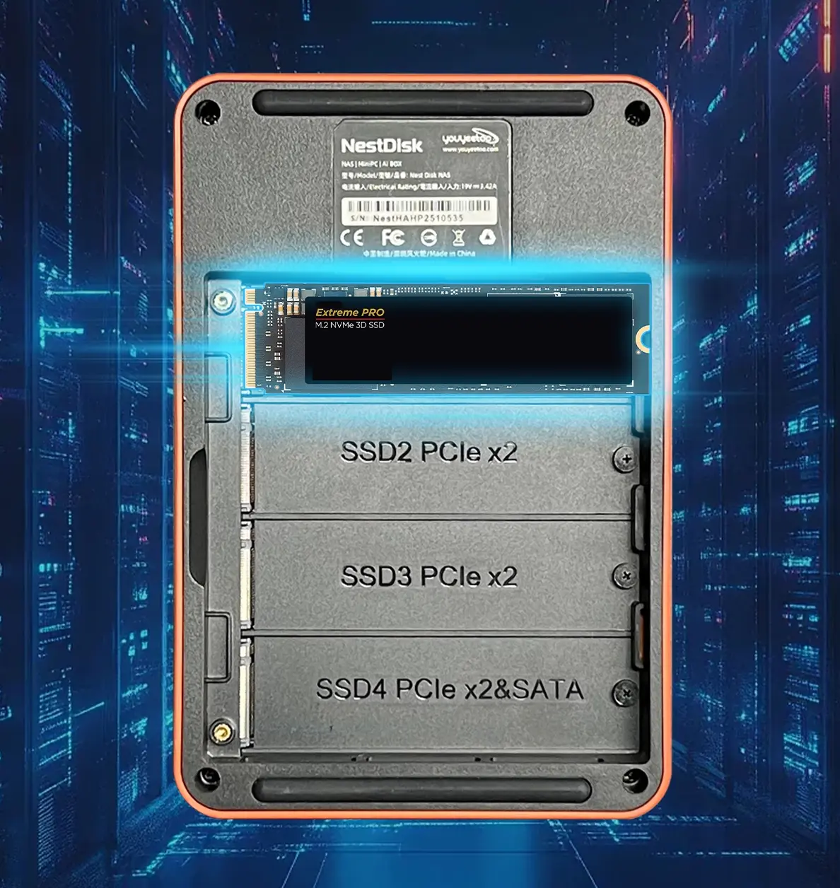

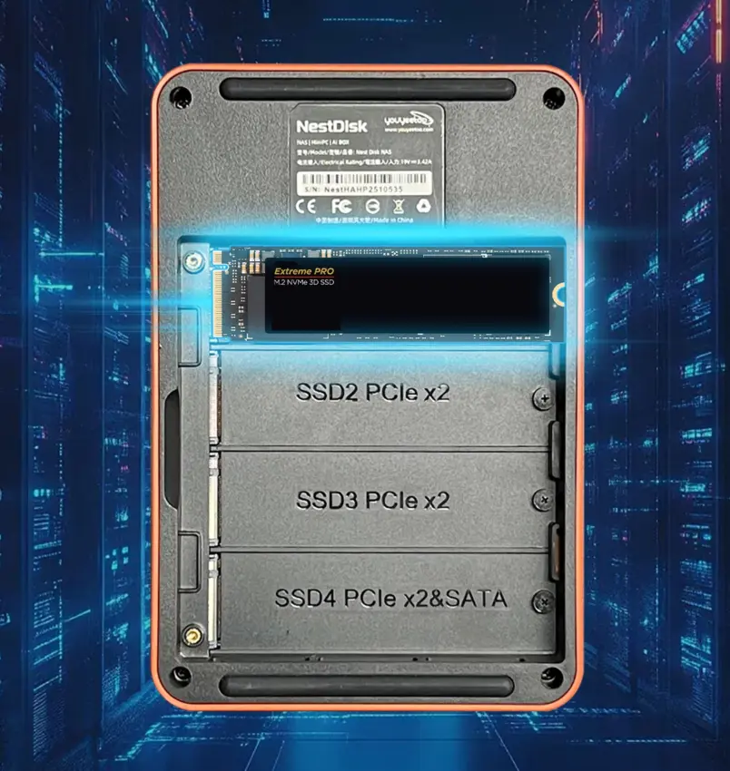

    • Up to 4× M.2 2280 PCIe Gen3 x2 slots (one supports SATA)

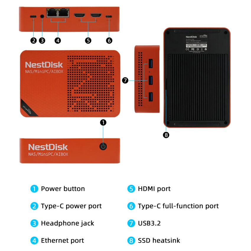

    • 2× HDMI 2.1
    • DisplayPort via USB-C
    • Up to three 4Kp60 displays
  • Networking:
    • 2× 2.5GbE (Intel i226-V)
    • Wi-Fi 6 and Bluetooth 5.2
  • USB:
    • 3× USB 3.0 Type-A
    • 1× USB-C (data, power, DisplayPort Alt Mode)
  • Audio: 3.5mm headphone jack, HDMI/USB-C digital audio
  • Cooling: Internal 30mm fan, optional external USB fans
  • Power: 19V/3.42A via dedicated USB-C power port, with power button

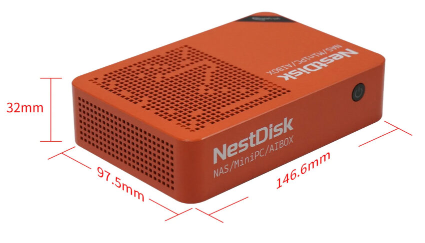

  • Dimensions: 146 mm × 97.5 mm× 32 mm
