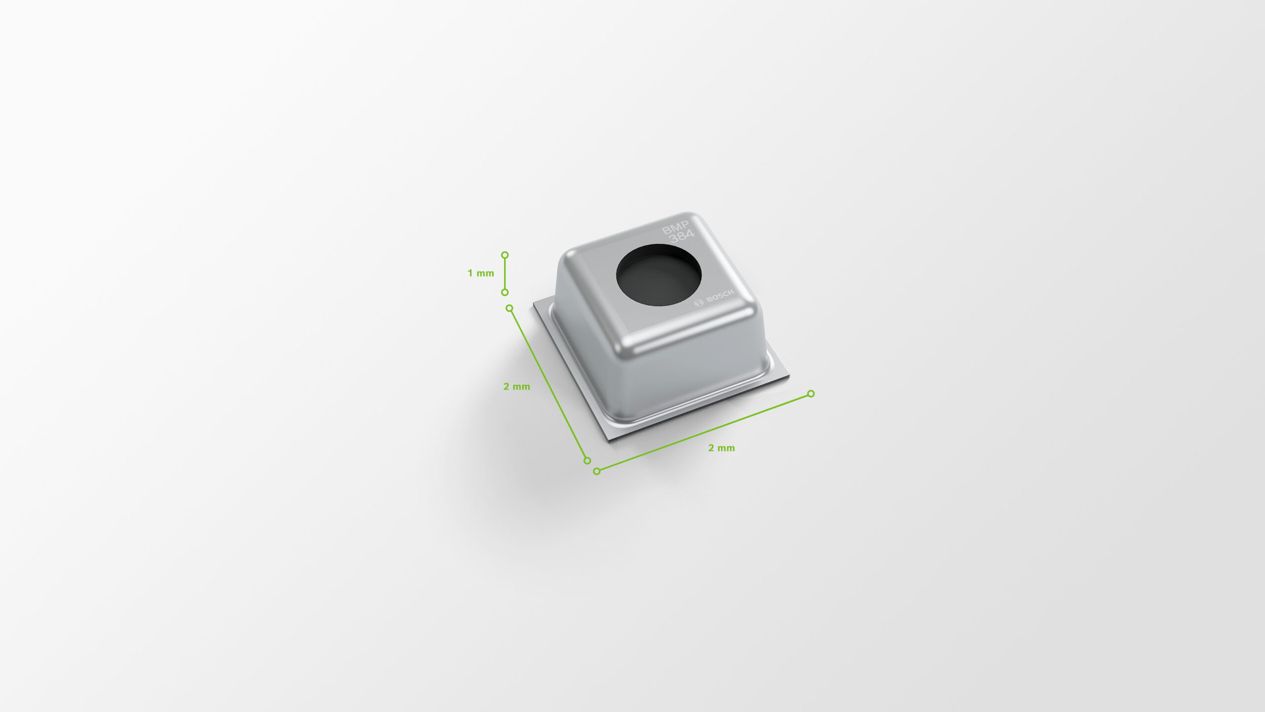

Bosch BMP384 Pressure Sensor offers a 1.2V to 3.6V supply voltage range and comes in a 2mm x 2mm x 1mm³ package. This sensor has a gel-filled cavity that allows higher robustness against liquids, water, and other chemicals.
Sensors by mixos
Bosch BMP384 Pressure Sensor offers a 1.2V to 3.6V supply voltage range and comes in a 2mm x 2mm x 1mm³ package. This sensor has a gel-filled cavity that allows higher robustness against liquids, water, and other chemicals. The BMP384 sensor is compatible for use with other Bosch Sensortec sensors, including the BMI088 for better performance. The small footprint of this sensor allows for outstanding design flexibility, and makes this a single package solution that can be easily integrated into existing and upcoming devices for smart homes, industrial products, and wearables.
In addition to the interrupt functionality that provides simple access to data and storage, the BMP384 sensor includes FIFO functionality that improves ease of use while reducing power consumption of the overall device system during full operation. Bosch BMP384 Pressure Sensor is ideal for applications of water-level detection and for precise differential barometric pressure measurement.

  • Low noise, 24-bit
  • 1.2V to 3.6V supply voltage
  • I2C and SPI interface
  • ±50Pa absolute accuracy rating
  • 200Hz maximum sampling rate
  • 300… 1250hPa operation range
  • 2mm x 2mm x 1mm³ package
