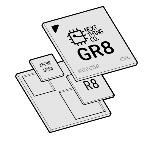

chippro_project_imgC.H.I.P Pro,  the newest addition to the Next Thing Co. family, is powered by GR8, a system-in-package (SiP) that was designed by Next Thing Co. GR8 features a 1GHz Allwinner R8 ARM Cortex-A8 processor, Mali400 GPU, and 256MB of Nanya DDR3 DRAM. in a 14mm x 14mm FBGA package. C.H.I.P. Pro is a system-on-module (SoM) that has 512MB of high-speed NAND storage flashed with NextThing Co.’s GadgetOS. Gadget is an Open Source Linux-based OS, software toolchain, and cloud infrastructure which is designed to bring the speed, openness, and productivity of modern software development to the world of embedded hardware. C.H.I.P Pro can be powered by USB or battery, intelligently managed by the AXP209 power management unit.

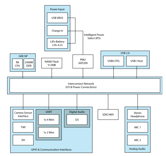

C.H.I.P Pro block diagram
C.H.I.P Pro design defines two possibilities of installations; either in a product or in a single board computer designed for a breadboard. Its SMT-ready castellated edges and elements on both sides will make reflow soldering not so preferable. Instead, header pins, a ‘debug board’, and two C.H.I.P Pro units are introduced in one package for only 49$ to make soldering easier and to start installing the unit in applications. Due to its size and efficiency, it could be a good competitor for Raspberry Pi Zero.

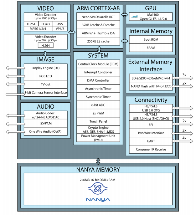

chipcoC.H.I.P. Pro is powered by GR8, a system-in-package provides a powerful application processor and DDR3 SRAM which eliminates the need for high-speed routing and reduces manufacturing complexity. GR8 is $6 in any quantity and includes the Allwinner AXP209 power management unit.
GR8 also features many popular peripheral interfaces: Two-Wire Interface, two UARTs (one 2-wire and one 4-wire), SD Card-ready SPI, two PWM outputs, a 6-bit ADC, I2S digital audio, S/PDIF IEC-60958 digital audio output, two HS/FS/LS USB PHYs (one USB 2.0 Host and one USB 2.0 OTG), a CMOS Sensor Interface.
GR8 Block Diagram
GR8 Block Diagram
Although it is doubtless that C.H.I.P. Pro will be installed and used in various projects, making GR8 module available for customers is something huge. Providing a jellybean part that contains an entire Linux system makes it possible to add the power of open software into any project and it opens the door for more applications to come.
