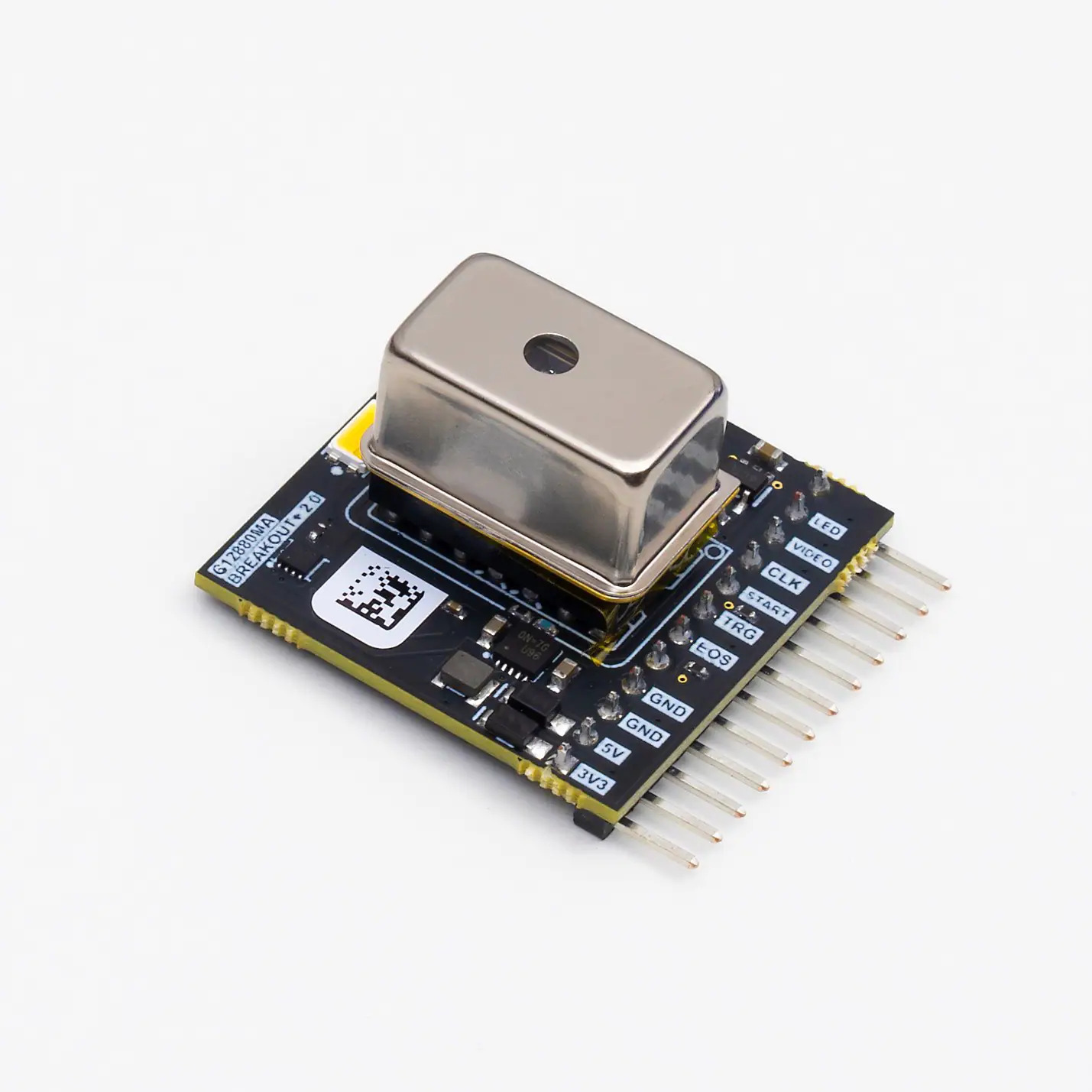

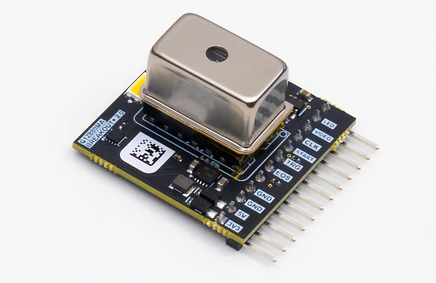

GroupGets’ MEMS micro-spectrometer offers a spectral response of 340 nm to 850 nm and 15 nm of resolution with an Arduino compatible breakout board
GroupGets’ C12880MA breakout board is a simple Arduino compatible breakout board for the Hamamatsu C12880MA MEMs micro-spectrometer. The C12880MA spectrometer is used to detect light wavelengths and their intensities. All power and signal pins on the C12880MA breakout board have been conveniently broken out, so it is easy to connect via jumper or breadboard to any system. This breakout board features a super bright white LED for illuminating a target to measure fluorescence responses.
  • Power input: 5 V
  • Wavelength detection: 340 nm to 850 nm
  • Digital interface: SPI
  • Dimensions: 25 mm x 24 mm (not including pins)
  • Temperature range: +5°C to +50°C
  • Resolution: 288 pixels
