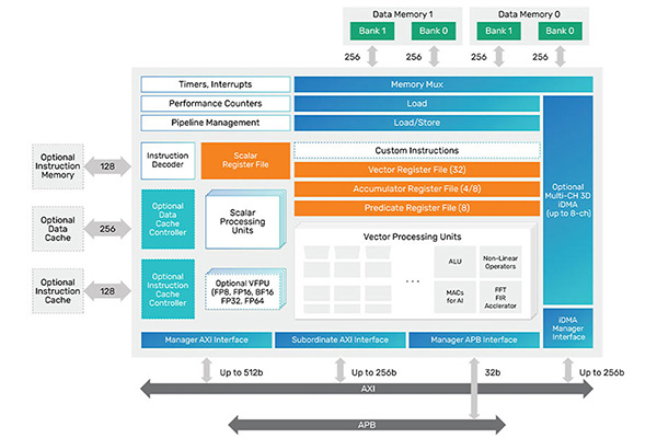

Block Diagram of Tensilica HiFi iQ DSP
The other essential improvement is the efficiency of power. The new DSP is able to save over 25% of energy on most tasks, and this makes it ideal in battery-operated devices that need voice processing all the time.
AI and Data Format Support
Given the needs of modern AI workloads, the HiFi iQ DSP has long-data-type support of formats (e.g. FP8 and BF16) frequently used by machine learning models. These extensions enable developers to execute neural networks and voice AI algorithms on the DSP with better efficiency.
The processor also has a larger SIMD vector processing and better auto-vectorization, which assists in faster processing of complex signals and AI processes. This simplifies software optimization by the developers who do not require much manual tuning.
