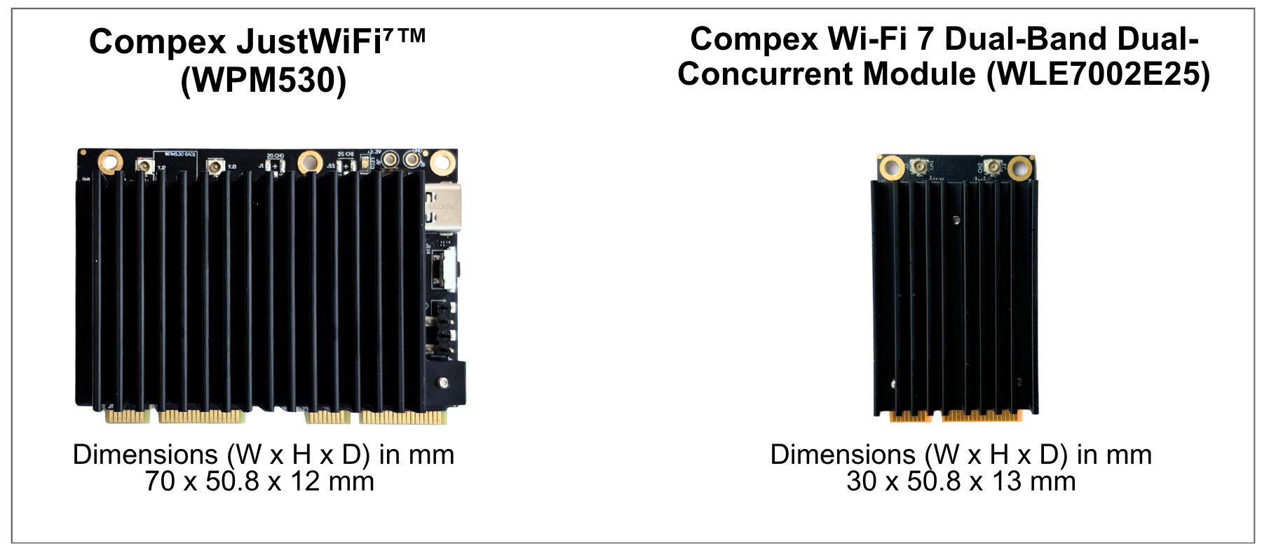

A side-by side look at Compex’ new JustWiFi7™ module (left) and its own mini PCIe-format Wi-Fi 7 module, both powered by Qualcomm.

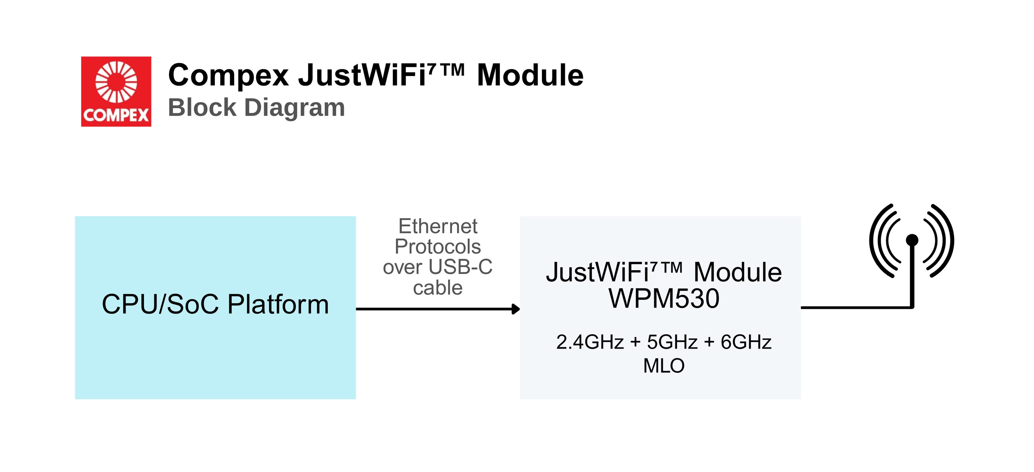

Compex JustWiFi⁷™ Block Diagram

Powered by Qualcomm’s IPQ5322 Quad-Core Cortex-A53 1.5GHz ‘Miami’ SOC and QCN6274 ‘Waikiki’ radio chipset, Compex JustWiFi⁷™ delivers true concurrent tri-band connectivity across 2.4GHz, 5GHz and 6GHz in a board about the size of two standard Mini PCIe adapters (70 x 50.8 x 12 mm). The connection to the host CPU is through Ethernet protocols at 10Gbps. With MLO support, JustWiFi⁷™ enables better throughput and low-latency performance, even on non-Qualcomm hosts, making it ideal for industrial, IoT and embedded systems. Whether you’re developing network appliances, smart devices, edge computing or enterprise solutions, JustWiFi⁷™ simplifies your wireless design while unlocking the full potential of Wi-Fi 7 capabilities.

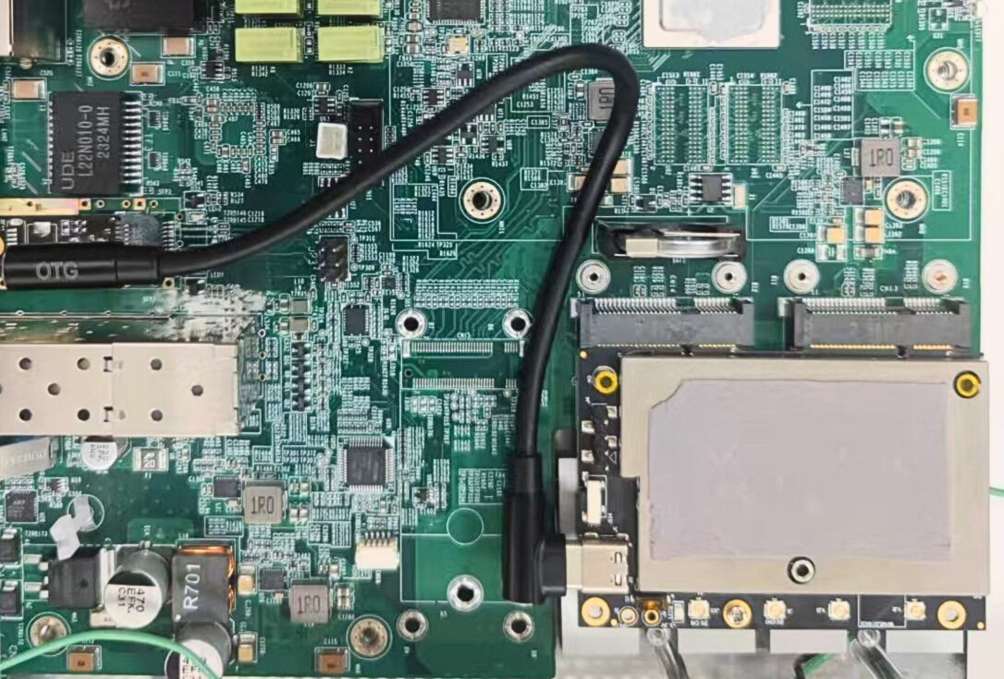

A typical application of JustWiFi⁷™ connected to a host board using the USXGMII interface for 10Gbps Ethernet data connection
