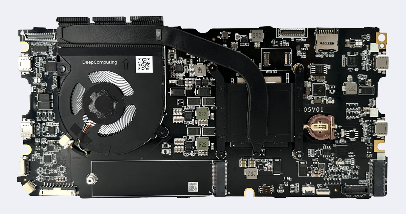

DeepComputing reveals its latest RISC-V single board computer (SBC) and third-generation product for the Framework Laptop 13, the DC-ROMA RISC-V Mainboard III, into Early Access Program. Designed specifically to engage developers and hardware enthusiasts, this exciting release showcases the power of the SpacemiT K3 RISC-V AI SoC and marks the first addition to an immature production-level environment that utilizes the newly defined RVA23 instruction set profile. The DC-ROMA RISC-V Mainboard III is the first modular mainboard for laptops globally that is built with the RVA23 instruction set profile capability.
The DC-ROMA RISC-V Mainboard III provides unrivalled performance and AI functionality to open desktop-class RISC-V systems and enables users to modify their modular laptops from a fixed architecture to an open RISC-V architecture, while retaining the existing 2.2-kilowatt power supply and shell used in the current PC model recess. At its core, the SpacemIT K3 system-on-chip contains 16 cores, eight of which adhere to the RISC-V RVA23 specification with the remaining cores developed to offload specific workloads and conform to the RVA22 architecture. The DC-ROMA RISC-V Mainboard III retains full functionality of the Framework expansion card system by incorporating four USB-C connections. Two of these four connections permit 65-watt PD 3.0 charging capabilities as well as DisplayPort 1.4 video output support for driving 4K monitors.

DC-ROMA RISC-V Mainboard III for Framework Laptop 13 Specifications:
  • SoC: SpacemiT K3

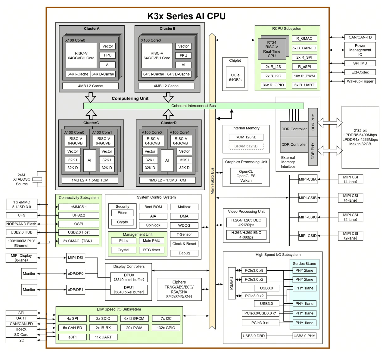

  • CPU and AI Subsystem:
    • 8× 64-bit RISC-V X100 high-performance cores up to 2.5 GHz (RVA23 compliant), ~130 KDMIPS
    • 8× RISC-V A100 AI accelerator cores with up to 1024-bit RVV 1.0 vector processing (RVA22 compliant), optimized for matrix workloads
    • AI compute capability up to 60 TOPS (INT4) via dedicated TCM memory and DMA acceleration
  • System Memory:
    • 16 GB or 32 GB LPDDR5 (dual-package)
    • 6400 MT/s data rate (~51 GB/s bandwidth)
  • Storage:
    • M.2 2280 Key-M slot with SATA or NVMe support
    • MicroSD (TF) card slot
  • Display:
    • 40-pin IPEX display connector
    • Compatible with Framework 13-inch 2.2K panel
    • 100% sRGB color gamut support
  • Camera: Integrated 1080p60 webcam
  • Audio:
    • Dual 2 W stereo speakers
    • Dual MEMS microphones with hardware privacy mute switch
    • 3.5 mm combo audio jack (headphone/microphone)
  • USB and I/O Expansion:
    • 1× USB-C (USB 3.0/2.0, DisplayPort 1.4 Alt Mode, USB-PD 3.0 up to 65 W)
    • 1× USB-C (USB 3.0/2.0, USB-PD 3.0 up to 65 W)
    • 2× USB-C (USB 3.0/2.0)
  • Wireless Connectivity:
    • M.2 Key-E 2230 slot (PCIe x1 + USB 2.0)
    • Supports Intel AX210, Intel AX200, and MediaTek RZ616 Wi-Fi modules
  • User Interface:
    • Full-size QWERTY keyboard support
    • Precision touchpad support
  • Security: Fingerprint reader interface
  • Power Supply: 55Wh battery support
  • Mechanical Characteristics:
    • Dimensions: 296.63 mm × 228.98 mm × 15.85 mm
    • Weight: 1.3 kg
  • Mechanical Construction:
    • CNC-machined aluminum top cover
    • Formed aluminum input cover and bottom cover
    • 3.5 kg-rated display hinges
SpacemIT K3 block diagram
Ubuntu 24.10 is the main supported OS (operating system) for the hardware of DC-ROMA RISC-V Mainboard III. It offers developers a reliable platform to develop code using RVA23 toolchains and upstream Linux packages.
