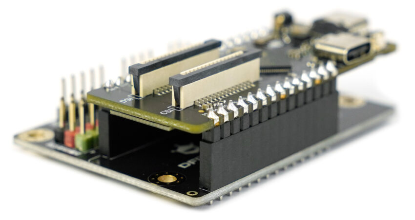

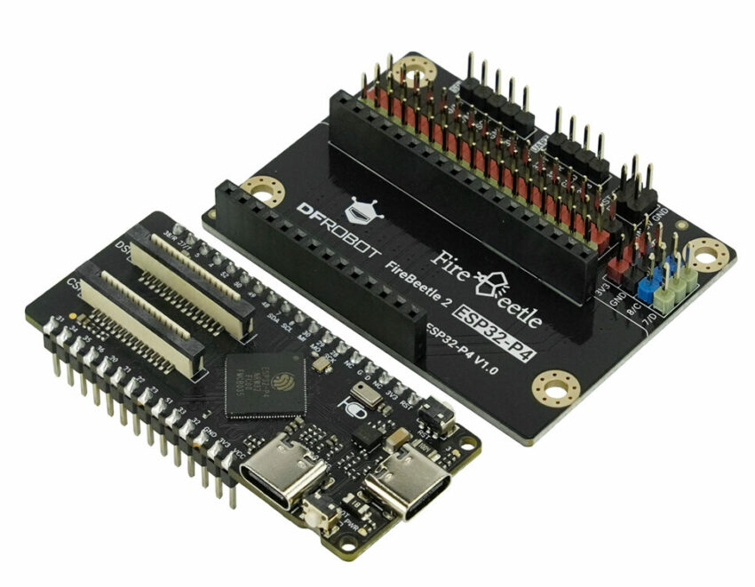

DFRobot has officially introduced the FireBeetle 2 ESP32-P4 AI Vision Development Board comprising a Dual-core RISC-V 360MHz CPU as well as a Single-core RISC-V 40MHz processor supporting single-precision FPU and AI extensions. At the same time, the development board also features an ESP32-C6 wireless module supporting Wi-Fi 6 and Bluetooth 5 communication, two USB-C ports, GPIO headers, on-board MIPI CSI and DSI connectors supporting up to 1080p@30fps image acquisition and display, making the newly launched dev-board ideal for compact and low-power Edge AI, Computer Vision work, and human-machine interface (HMI) workloads.

ESP32-P4 Development Board & IO Expansion Board
The FireBeetle 2 ESP32-P4 Dev Module can be programmed through the Arduino IDE. The board also supports ESP-IDF with RTOS, and it can run small machine learning models using TensorFlow Lite for Microcontrollers with ESP-DL or other tools. The onboard ESP32-C6-MINI-1 module may support Matter and Thread for Smart Home use. DFRobot also gives docs, tutorials, and code examples on their Wiki page.
