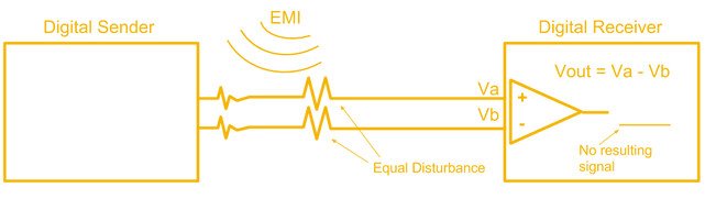

If you’re not familiar with differential communication, the method behind it is straightforward; the line has two channels (positive and negative), where each line has the same signal but with an opposite voltage. The receiver then will calculate the difference between them. Mathematically:
Vb = -Va, So:
Vout = Va – Vb = Va – (-Va)
Image Source: Hackaday
Now, what if there was a noise?. The noise will affect almost identically on both signals with the same voltage level. As a result the receiver can omit the noise in the output.

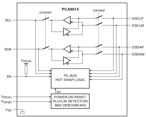

Back to I2C; Joshua used PCA9615 chip from NXP which is a bridge between the normal 2-wire I2C-bus and the 4-wire DI2C-bus.
PCA9615 Block Diagram.
PCA9615 Block Diagram. DSCLP and DSCLM are the clock plus/minus input/output respectively. While DSDAP and DSDAM are the datat plus/minus input/output.

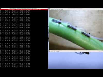

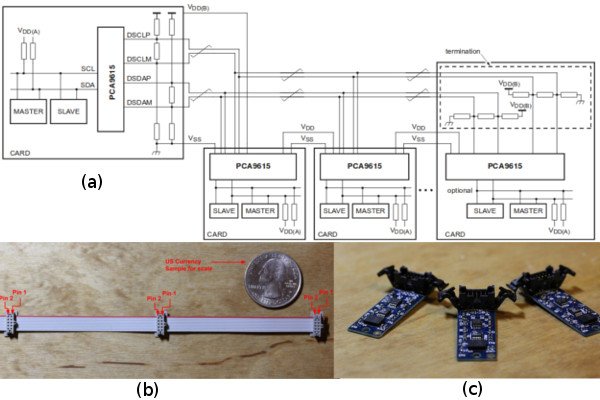

As an use case; Joshua used DI2C to build an IMU Noodle for modeling a piece of foam twisting and turning in a 3D space simulator using data comes from a string of cards contain the BNO055 sensor and PCA9615 bridge.
PCA9615 was used in each Joshua’s card to bridge the normal I2C signals to DI2C ones. By bridging I2C to DI2C, PCA9615 makes the capability of using longer cables and I2C more rugged in noisy environments.
(a) PCA9615 Application Diagram (b) Ribbon-cable Connectors. (c) BNO055 with PCA9615 Module.
The PCB design files (KiCAD) and firmware can be downloaded from Joshua’s repository on Github. Moreover, Joshua mentioned important tips to setup DI2C in your next design. You can see these tips in his blog post on Hackaday.
IMU Noodle in Action
