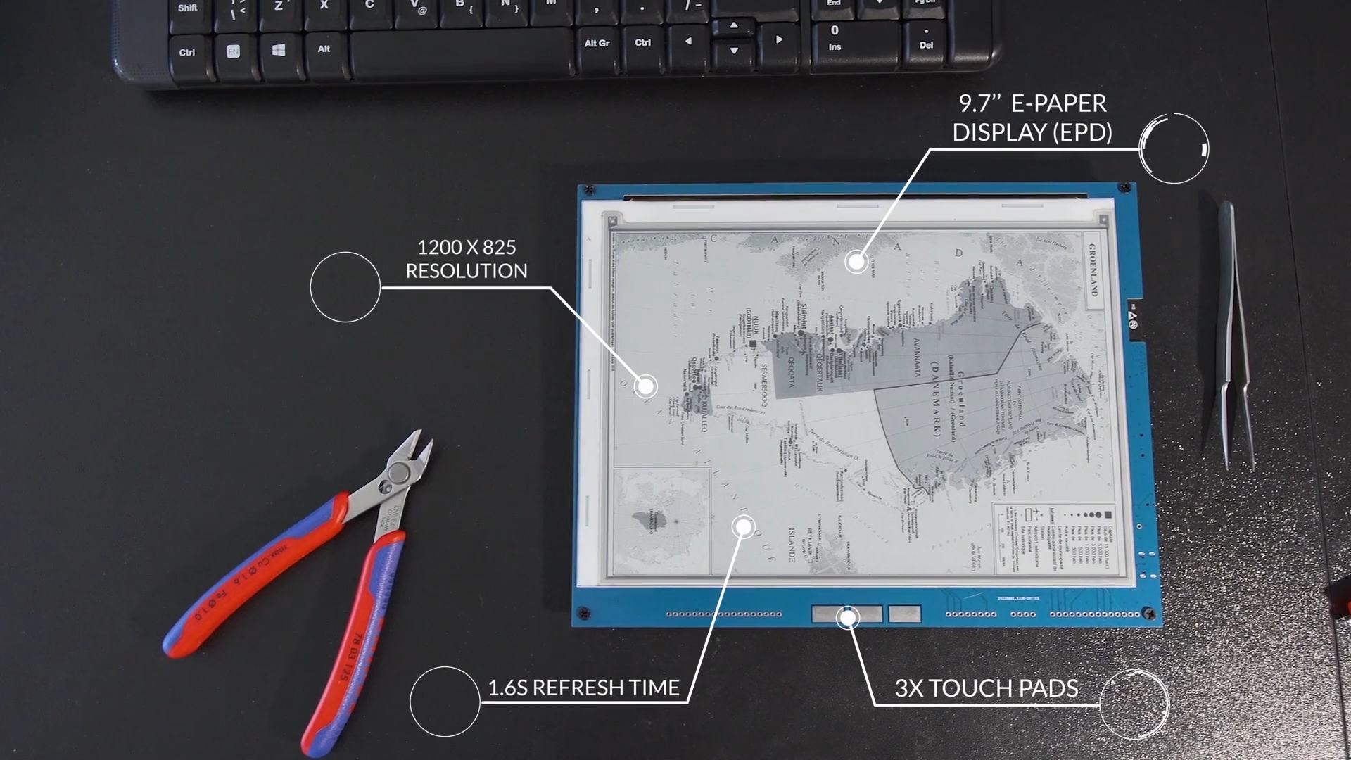

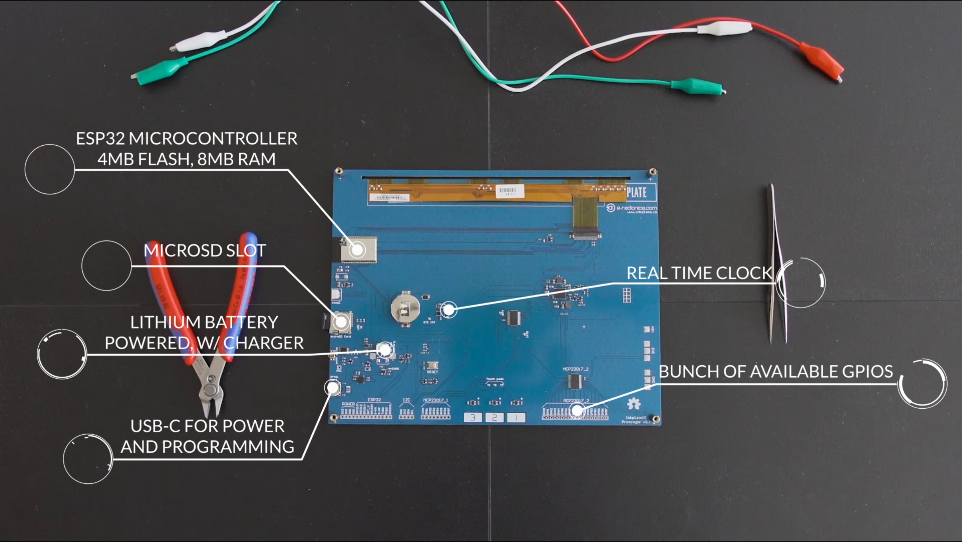

Compared to its predecessor, the hardware comes with a 9.7-inch display and high screen resolution of 1200×825 pixels with 1.61 second refresh time in black & white mode, and 1.81 second refresh time in grayscale mode. This powerful and energy-efficient design is based around the famous ESP 32 WROVER module, a dual-core microprocessor providing 8 MB RAM, 4 MB of flash memory, and support various wireless communication protocols, including Wi-Fi and Bluetooth 4.0.
Inkplate 10 Product
With its minimalistic design, the e-paper display packs a rich set of interfaces including the USB Type-C port that can be used for programming as well as to power the hardware. The display has additional GPIO pins that come along with support for I²C, SPI, and easyC/Qwiic connectivity. To increase storage, you get an optional MicroSD card reader for storing images to be displayed.
Thanks to the low power consumption that achieves 22 µA sleep states allowing it to last for months on a single battery. To add more to the hardware part, boost with three capacitive touchpads – usable through the optional enclosure. At just 23 x 18 x 1 cm and weighing 260 g, it adds more features than you would ever want at $139.
