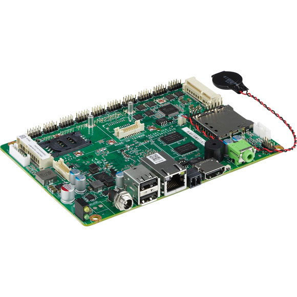

EMBUX introduces its newest ARM embedded board, the EBC3A1-1G Y0, particularly intended for machine manufacturers and system integrators. The embedded board is selectively based on the NXP ARM Cortex-A9 i.MX6 processor to ensure high performance at a lower cost.
EMBUX introduces its newest ARM embedded board, the EBC3A1-1G Y0, particularly intended for machine manufacturers and system integrators. The embedded board is selectively based on the NXP ARM Cortex-A9 i.MX6 processor to ensure high performance at a lower cost. With multiple, distinct I/Os, the sky’s the limit as to how to connect the EBC3A1-1G Y0 with different interfaces in ATM kiosks, vending machines, and industrial gateways/controllers.
ARM yourself with the best processor for automated uses
ARM processors are typically used for site-specific devices, like automated vending and ATM machines and other embedded systems, due to its low power consumption and smaller size. However, EMBUX embraces the advantages in cost/performance ratio and size with our meticulous selection of the ARM Cortex-A9 i.MX6 processor for our scalable embedded system solution, saving you space and energy. The 10.8 to 26.4 VDC wide input voltage range also allows the device to have versatility in usage environments.
Rich I/O selection makes this your flexible friend
As a compact 3.5” board, the EBC3A1-1G Y0 integrates easily with ATMs, in addition to vending, parking, and other automated machines. The assortment of I/Os gives the computer flexibility in connectivity options. Multiple USB and RS-232 ports are available to link to site-specific devices, while the CAN bus makes the board suitable for transportation vehicle uses. Additionally, having both HDMI and LVDS connectors allows flexibility in taking advantage of the graphics support. Lastly, the EBC3A1-1G Y0 offers mini-PCIe expansion sockets for additional needs or extra ports.
Main Features
  • ARM Cortex-A9 i.MX6 DualLite 1.0 GHz
  • Onboard DDR3 1GB, 4GB eMMC Flash
  • HDMI, 18/24-bit LVDS output
  • 6 x RS-232, 2 x RS-485, 2 x CAN, 4 x USB 2.0
  • Dual mini-PCIe for Wi-Fi/3G support
  • 10.8~26.4 VDC wide power input
  • Diversified OS support for Yocto/Android/WEC7 (OEM)
Ordering Information
EBC3A1-1G Y0 (P/N: 10E0003A106X4)
3.5″ SBC, i.MX6DL 1GHz, DDR3 1GB, 2 x mini-PCIe, with Yocto OS, HDMI/LAN/4GB, eMMC/4 x USB/6 x RS 232/2 x RS, 485/2 x CAN/10.8V 26.4V
