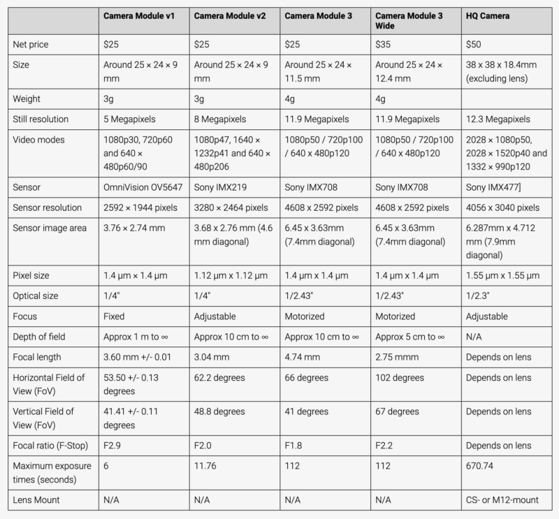

Hardware specification table

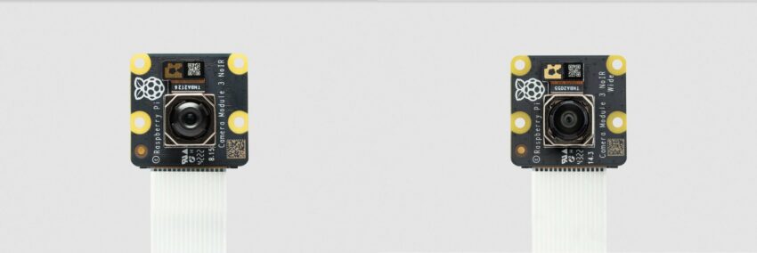

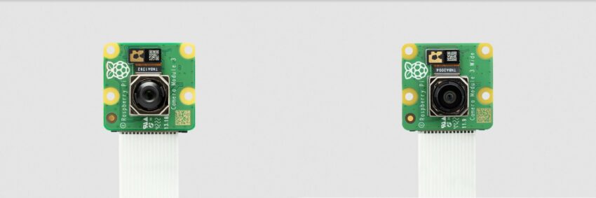

CM3 Standard & Wide
 CM3 NoIR Standard & Wide

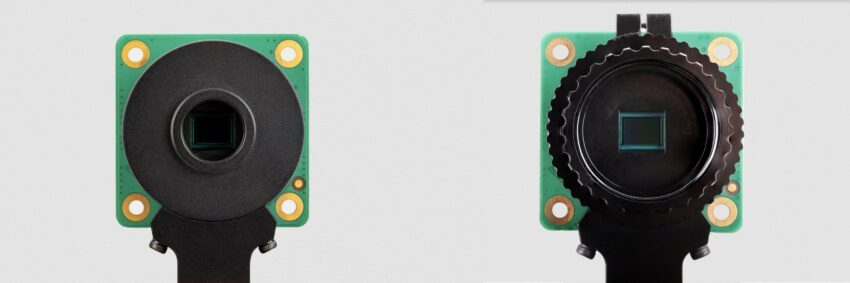

HQ Camera w/ M12-mount & C/CS-mount
Raspberry Pi released a new version of its high-quality camera that works with lenses that have a native M12 mount. In the announcement, it was also said that these new modules would only work with libcamera and Picamera2, not with the old camera stack. Check out the libcamera page for more information. Online stores like CanaKit and PiShop. US sell the Raspberry Pi Camera Module 3 and the NoIR version for about $25. For $35.00, you can buy the “Wide” version of these modules. Look at the bottom of the product page to see who else sells it in the U.S. and around the world. The price of the HQ camera with an M12 mount will be around $50.
