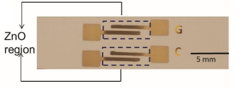

About an Inch Long Small, Flexible, and Rod-Shaped Device
In order to make wearable biosensors as successful consumer products it is important to demonstrate enhanced multiplexed functionality, reliability, and ease-of-use through non-invasive (without skin break) monitoring of body fluids. Thus, researchers designed and fabricated 3-D nanostructured semiconducting ZnO sensing elements to establish optimal electron transfer efficacy between 4 immobilized glucose and cortisol molecules and the electrode surfaces. ZnO has been successfully used as electrode material for enzyme immobilization and glucose detection.
