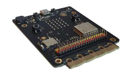

The HiHope_NearLink_DK_WS63E_V03 is a compact $7 development board built around the HiSilicon NearLink WS63E SoC with Wi-Fi 6, Bluetooth LE 5.2, and SparkLink Low Energy (SLE). It targets Smart Home and AIoT applications where low power consumption and strong wireless connectivity are essential.
The HiHope_NearLink_DK_WS63E_V03 is a compact $7 development board built around the HiSilicon NearLink WS63E SoC with Wi-Fi 6, Bluetooth LE 5.2, and SparkLink Low Energy (SLE). It targets Smart Home and AIoT applications where low power consumption and strong wireless connectivity are essential. The board is compatible with OpenHarmony OS and can be programmed using Hispark Studio.
The SoC integrates a 240 MHz 32-bit CPU, 606KB SRAM, and 4MB flash. Wireless support includes Wi-Fi 6 (2.4 GHz) with WPA3, BLE 4.0–5.2 with mesh and multicast, and SLE 1.0 offering up to 12 Mbps data rate. Security features include AES, RSA, ECC, SHA256, hardware RNG, and secure boot via eFuse. The board also includes SPI, I2C, I2S, UART, ADC, PWM, and GPIO headers, USB-C for power and programming, and support for external antennas. Applications span wearables, smart appliances, industrial senso.
