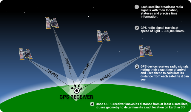

GPS
Thanks to on-the-shelf GPS modules/receivers from vendors like: Neoway and u-blox it’s easy to embed a GPS receiver into your project. What you need is a module sending its messages via UART to the MCU and a ready-made antenna attached to the module. There is a standard format for these modules messages called NEMEA. These messages contain information about the location that includes longitude, latitude, direction, speed … etc. These receivers need to see at least 4 satellites to compute a position.
There are many navigation systems like the Russian GLONASS, the European Union’s Galileo and the American GPS.
Image courtesy of: Geneko
GPS is mainly designed to be an outdoor location detection system. Therefore, its performance decreases in enclosed places and across crowded areas with buildings.

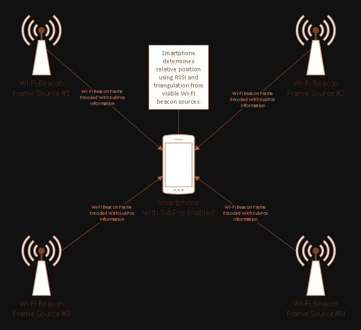

WiFi
WiFi can be used in location detection (AKA Wi-Fi positioning system) when your phone or WiFi transceiver module like ESP32 or ESP8266 is near hotspots. You can consider WiFi like a coexisting system with GPS for indoor areas. Moreover, WiFi can be used to detect the location inside the enclosed/underground area; you can see the SubPos project on Hackaday to know how.
Image Courtesy of Blecky
Location detection systems using WiFi use techniques based on received signal strength indication (RSSI), angle of arrival (AoA) and time of flight (ToF). You can read more about these techniques from the Wikipedia article.
