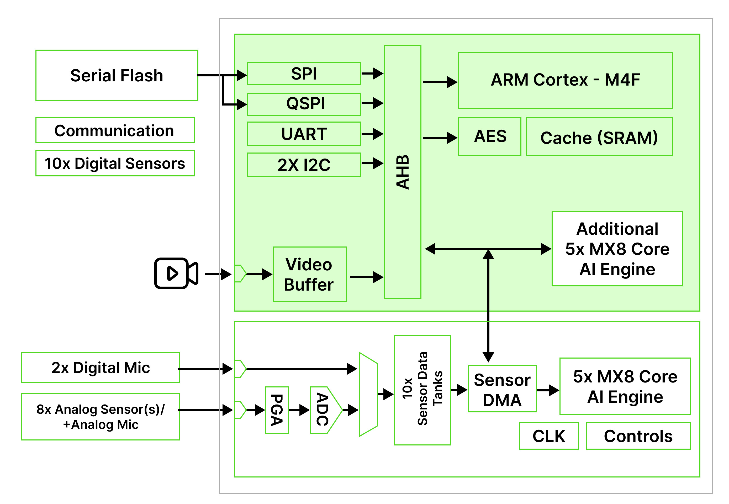

The AI processing is carried out by two groups of five MX8 AI cores each, with separate power domains. One set is in an always-on block that enables ultra-low power sensor interfacing and fusion. For example, when performing always-on keyword spotting the chip consumes less than 100µW. The 10 MX8 cores can perform up to 2,560 multiply-accumulate (MAC) operations per cycle with total peak AI throughput of 512 GOPs. The GPX10 Pro additionally includes an Arm® Cortex®-M4F CPU core for legacy control functions. Integrated analog features include an ultra-low power ADC, enhanced I2S logic and interfaces to up to eight concurrently operating analog and 20 digital sensors. The GPX10 Pro AI MCU also supports 8-bit, 16-bit and 32-bit operations for flexible precision and power saving. The GPX10 Pro accelerates common edge AI functions like voice recognition, keyword spotting, low frequency computer vision and intelligent sensing significantly faster and with substantially less computational power than today’s MCUs, NPUs or GPUs.

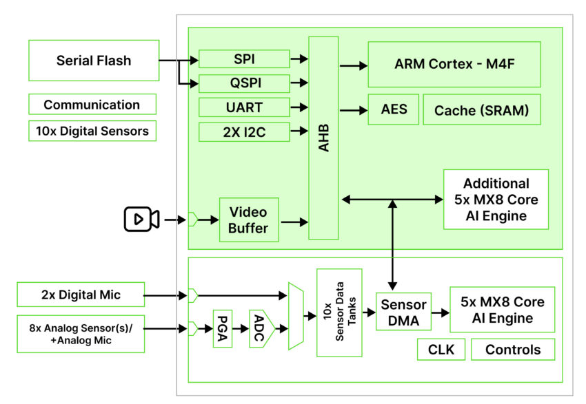

GPX10 Pro block diagram

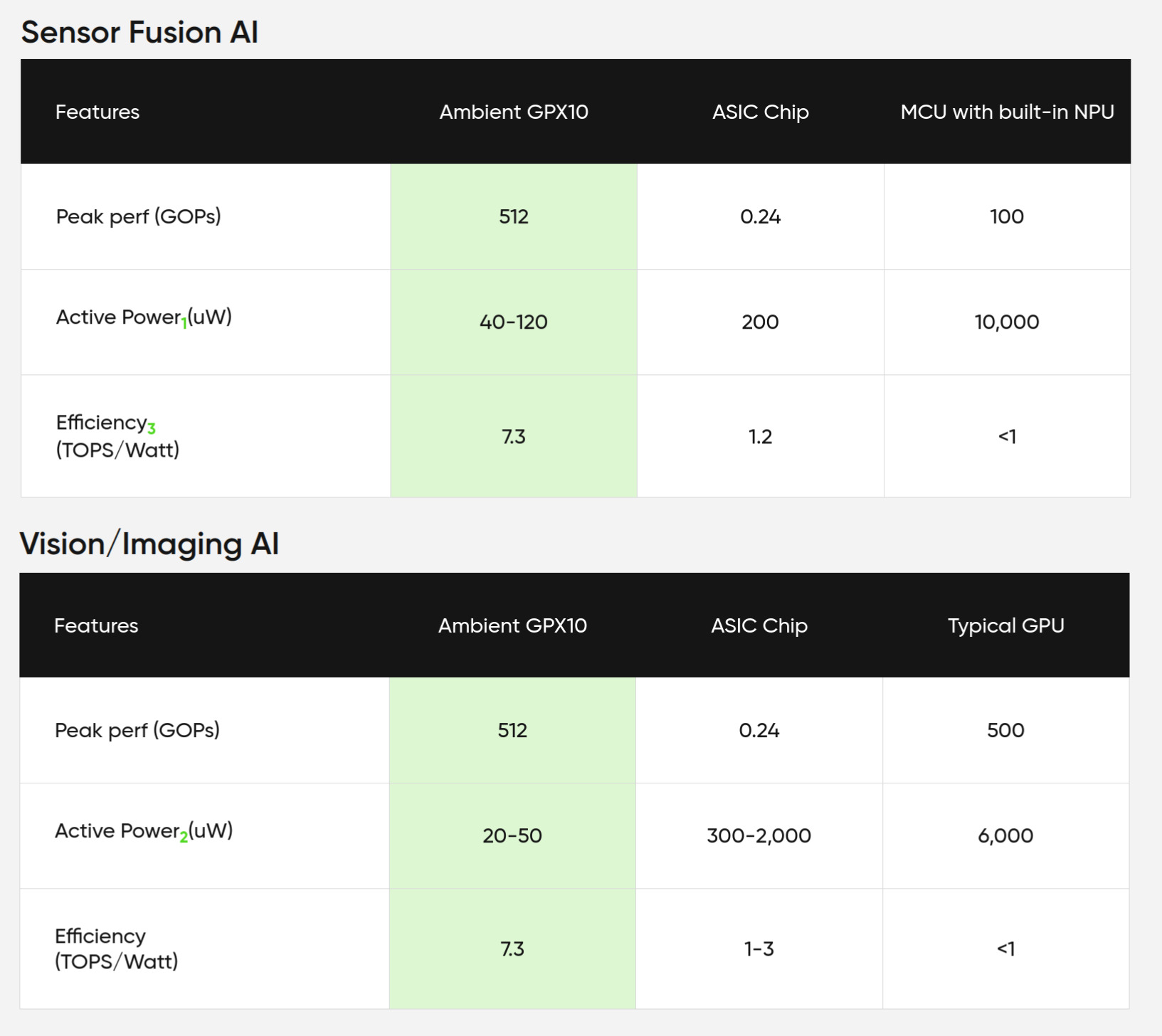

Ambient GPX10 Pro vs ASIC vs MCU with NPU

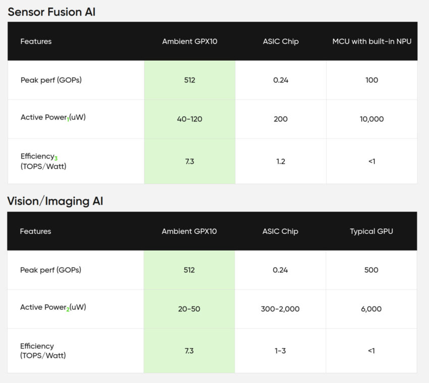

Ambient Scientific also provides certain performance metrics for Sensor Fusion AI and Vision AI workloads, comparing the 512 GOPS GPX10 with a dedicated ASIC chip and a general MCU with an integrated NPU. Note this is for the earlier GPX10, not the new GPX10 Pro, but the ten MX8 cores look to be the same, and the Pro model mainly has extra memory (2048 KB vs 256 KB) and various improvements.
