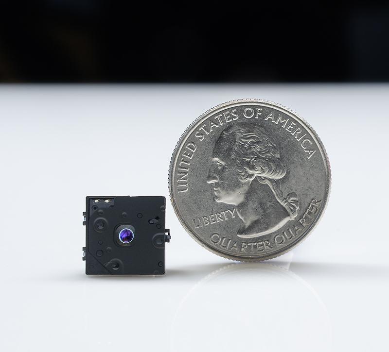

We all know that getting thermal cameras that are based on FLIR Lepton modules can really be much of a budget to plan for if you're considering getting one. This is why we are excited to introduce to you a new cost-effective solution called the Teledyne FLIR Lepton FS module – a non-radiometric 160 x 120 resolution micro thermal camera module that sells for about half the price of an ordinary FLIR thermal camera module.

Currently, the Lepton FS module which sells for $99, costs the lowest in the Lepton family. This was achieved by notably reducing the thermal sensitivity, scene dynamic range, and up to 3% inoperable pixels. If you need an imager and not a radiometric sensor, these specs will just be very good and worth your money.

Key Features and Specifications of the FLIR Lepton FS Module Include:
  • Sensor technology: Uncooled VOx microbolometer
  • Spectral range: Longwave infrared, 8 μm to 14 μm
  • Array format: 160 x 120, progressive scan
  • Pixel size of 12 μm
  • Effective frame rate of 8.7 Hz
  • Thermal sensitivity: <75mK NEdt
  • Operability
    • Number of non-defective pixels is 97%
    • Temperature compensation is automatic, and,
    • Output image is independent of camera temperature.
  • Non-uniformity corrections: Integral Shutter
  • Scene dynamic range
    • High Gain Mode: -10 ~ 140°C typical
    • Low Gain Mode: -10 ~ 350°C typical
  • Image optimization: Factory configured and fully automated
  • FOV:
    • horizontal: 57°
    • diagonal: 71°
  • Lens Type: f/1.1
  • Output format: User-selectable 14-bit, 8-bit (AGC applied), or 24-bit RGB (AGC and colorization applied)
  • Integral solar protection
  • Host interfaces: SPI for video data, CCI (I2C-like) for control
  • Input supply voltage: 2.8 V, 1.2 V, 2.5 V to 3.1 VIO
  • Power consumption:
    • 150 mW operating
    • 650 mW during shutter event
    • 5 mW in standby mode
  • Temperature Range:
    • Operating: -10C ~ +65C
    • Storage: -40 C ~ +80 C
  • Dimensions: 11.50 mm x 12.70 mm x 6.84 mm
  • Weight: 0.91g
  • Shock: 1500 G @ 0.4 ms
