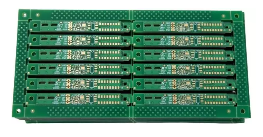

1. Panelize Your PCBs Correctly
Panelization is the placement of smaller boards into multi-board arrays to gain manufacturing efficiency.Panelization plays a vital role in the PCB assembly process. And to progress through the PCB assembly process without complications requires using correctly panelized PCBs.
Generally, it is best to leave the PCB panel design to your PCB manufacturer since they know all the requirements and how to implement them. However, should you decide to do the PCB panelization yourself, make sure you follow the design guidelines. Particularly, if your PCB has overhanging components, there needs to be enough spacing between the individual PCBs in the panel so that overhanging components do not overlap adjacent PCBs.

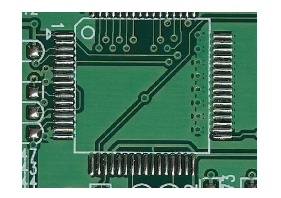

2. Make Sure Your PCB Silkscreen is Legible
The silkscreen resides on the top layer of a PCB, and it displays useful and necessary information for anyone assembling, testing, or troubleshooting a circuit board. Silkscreen markings are used to indicate component placement locations, component values, reference designators, warning symbols, component polarity, test points, board name & revision, and more. It follows that the non-readability of the silkscreen could create bumps in the assembly process and sabotage the completion date. So, what is a good size for the silkscreen text? In many cases, a line width of about 0.2 mm works well.

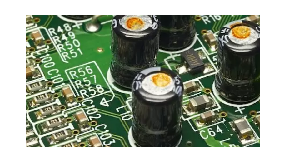

3. Indicate Component Polarity
A polarized component is one that is electrically non-symmetrical. (Large Capacitors, Diodes, ICs, and Transistors are always polarized. Resistors are non-polarized). So, there is a right and wrong way of placing it on a PCB. Overlooking component polarity could cause damage to components, the board or result in a non-functioning circuit board and delay the PCB assembly process. So, polarized components need to have polarity indicators marked on the silkscreen space outside the component board’s installation location.

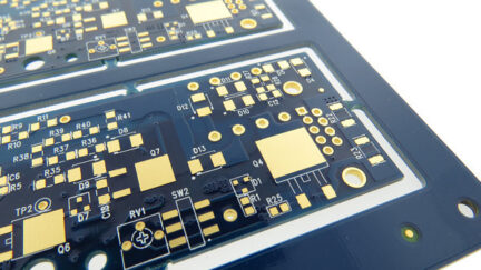

4. Include PCB Fabrication and PCB Assembly Drawings
Make sure that your PCB manufacturer receives all details. The more specific you are in communicating your requirements, the less chance for errors, assumptions, costly mistakes, and delays. So, informing your vendors of your needs using PCB fabrication and PCB assembly drawings is an excellent idea. The fabrication drawing contains specifications for your bare board that the PCB manufacturer must know, and it should include the following:
