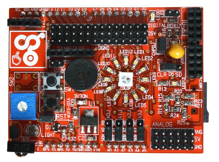

The Idiotware Shield is a learning platform that offers both novices and advanced Arduino users
the opportunity to bring hundreds of projects to life quickly. it offers a large variety of wireless communication options, input sensors, outputs, storage and device extensibility.
The idIoTware shield has a built in lm35 sensor that has a sensitivity of 10mV / oC, that means according to this equation: Temperature ( oC) = Vout * (100 oC/V)
That if Vout is 0.5V , then, Temperature = 50 oC. However, this built-in sensor gives a higher analog voltage on pin A0 if a higher temperature was applied.
To set up the IdIoTware shield you need to connect  LM35 sensor to SEL0 3 pin header by using a jumper. The SD card should be connected to D6 and SD pin header, thus we need antoher jumper to enable it.
