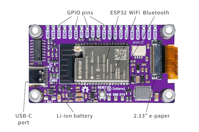

“The Inkplate 2 is an Arduino-compatible board that features a 2.13″ three-color e-paper display,” the company explains. It is a ‘Plug ‘n’ play device, programmable via USB port, and controller by ESP32 microcontroller. Moreover, it connects to the internet via WiFi or Bluetooth. Since it uses only 8uA in low-power mode, it can last months on a single Li-ion battery charge. It’s simple enough to be used by beginners, but it also offers plenty of features and a simple platform for advanced users. Simply said – it’s the easiest way to add an e-paper display to your project.”
The simple, easy-to-use Arduino-compatible device has a lot packed in a small factor board. It is driven by a low-cost low-power ESP32 dual-core microcontroller with integrated WiFi and Bluetooth connectivity. It also has 8MB PSRAM and 4MB flash storage as well as a USB-UART converter with a Type-C port for easy programming. The board can be programmed with Arduino IDE or Micropython.
The device’s hardware is plug ‘n’ play; simply connect it to your computer using the USB cable that comes with it and it starts working, nothing more. There’s also an onboard Li-ion charger that charges your battery and makes it last for a long.
The 2.13-inch e-paper display has a natural look with high contrast and beautifully clean lines. It works well in any environment and has a really wide viewing angle (almost 180°). It has a 212 x 104-pixel resolution, 15-second full-screen refresh time, and is able to show text and images in three different colors at the same time (red, black, and white).
Specifications:
  • ESP32-WROVER-E wireless module equipped with ESP32 dual-core MCU with WiFi 4 and Bluetooth 4.0 connectivity, 8MB PSRAM, 4MB flash
  • External flexible IPX antenna
  • 2.13-inch ePaper display with:
    • Screen resolution: 212 x 104 pixel
    • Screen colors: Black, white and red
    • Pixel size: 0.229 mm x 0.228 mm
    • Pixel density: 111 dpi
    • Full screen refresh time: 15 seconds
  • 1x USB Type-C port
  • 20-pin header with GPIOs, I2C, UART, 3.3V and GND
  • easyC I2C connector with the Qwiic connector
  • Power Supply:
    • 5V via USB Type-C port
    • Li-ion battery, MCP73831 charger IC
  • Power consumption: 8uA
  • Dimensions: 65.2 mm x 35.3 mm
