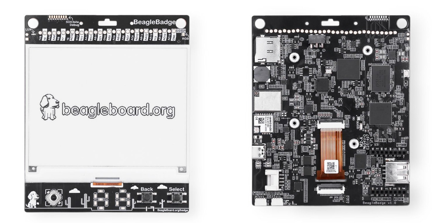

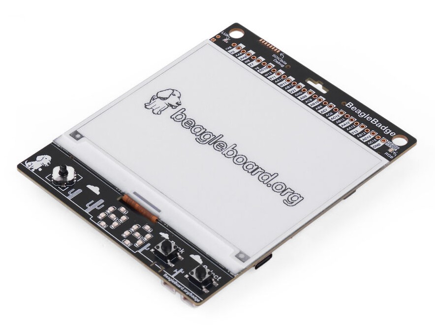

The BeagleBoard.org Foundation has launched the BeagleBadge, a compact IoT wearable development platform built for developers working on embedded systems, edge computing, and connected devices. It combines sensing, wireless connectivity, and expansion interfaces into a single board that supports rapid prototyping of smart wearables, interactive badges, and distributed IoT nodes. The design focuses on flexibility, making it suitable for both experimentation and real-world deployment.
At its core, the board uses the Texas Instruments AM62L32 Sitara SoC, which delivers balanced performance and power efficiency. The dual-core Arm Cortex-A53 CPU runs at up to 1.25 GHz and includes built-in security features such as secure boot and TrustZone. Hardware acceleration for AES, SHA-2, RSA, and ECC improves cryptographic performance, which makes this IoT wearable development platform suitable for secure edge applications and connected systems.
BeagleBadge Top and Bottom Side

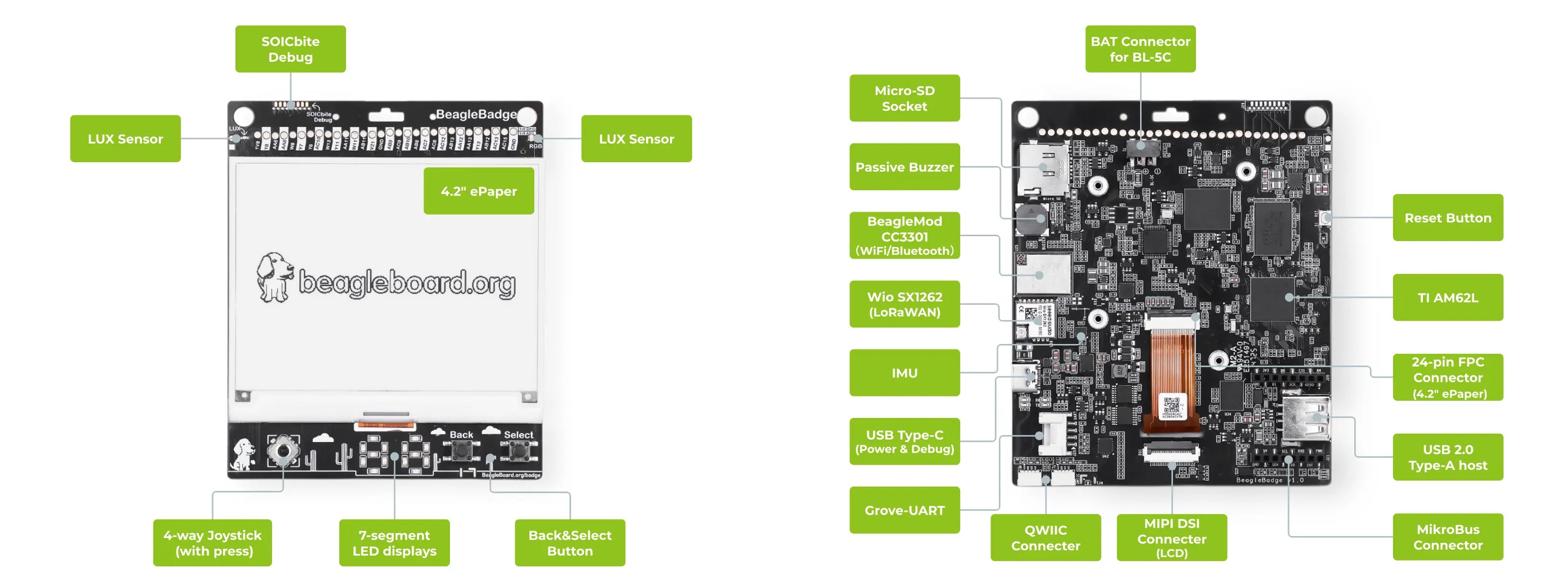

BeagleBadge Specifications:
  • Processor:
    • SoC: TI AM62L32 (low-power SoC for IoT and HMI)
    • CPU: Dual-core Arm Cortex-A53 @ 1.25 GHz
  • Memory:
    • RAM: 2GB LPDDR4 (128M × 16-bit)
    • Speed: Up to 1600 MT/s (3200 Mbps)
  • Storage:
    • eMMC: 4GB onboard
    • Flash: 256Mb OSPI flash
    • EEPROM: 32KB
    • Expandable: microSD card slot
  • Wireless Connectivity:
    • Wi-Fi: 2.4 GHz (802.11 b/g/n) via CC3301 module
    • Bluetooth: BLE 5.x via CC3301
    • LoRaWAN: SX1262 module with u.FL antenna connector
  • USB:
    • 1× USB Type-C (power + debug)
    • 1× USB 2.0 Type-A host
    • 1× microSD socket
  • Display:
    • 4.2-inch ePaper display (24-pin FPC connector)
    • MIPI-DSI connector for LCD display
  • Sensors:
    • IMU (accelerometer + gyroscope)
    • Ambient light sensor
    • Temperature & humidity sensor (unpopulated)
  • Expansion Interfaces:
    • 1× mikroBUS connector
    • 1× Grove connector
    • 2× QWIIC connectors
    • ~25 GPIOs via headers
  • Misc:
    • 1× Reset button
    • 2× Tactile buttons (Back, Select)
    • 1× 4-way joystick with press
    • 1× Passive buzzer
    • 1× RGB status LED
    • 2× 7-segment LED displays
  • Power:
    • Battery: BL-5C Li-Ion connector
    • Fuel gauge monitoring support
  • Dimensions: 92 × 111 × 18 mm
BeagleBadge Top and Bottom Side Specifications
