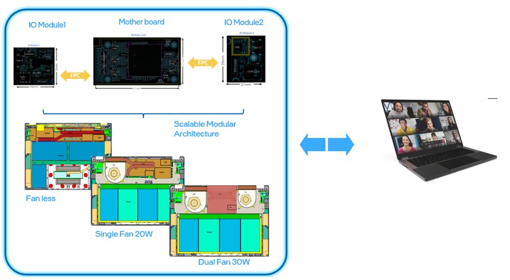

Intel proposes a setup that breaks a laptop motherboard into three pieces (instead of the usual all-in-one approach), with sub-boards on the left and right (where your USB and HDMI ports go) that can be customized by the manufacturer to support their particular I/O needs. That means that the central motherboard (including the processor and cooling setup) could be upgraded separately from the left and right components.

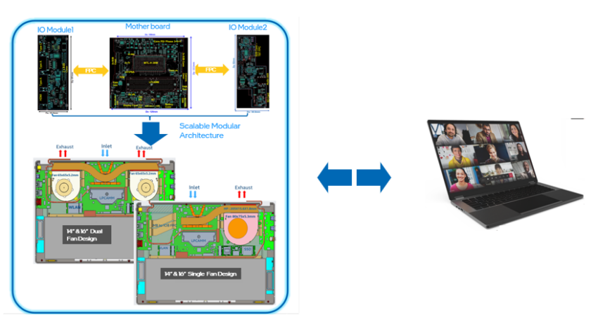

The proposed design features separate components for the new LPCAMM memory standard, along with commonly upgraded parts like Wi-Fi and SSDs, which can be swapped using M.2 cards. According to Intel, these designs enable seamless scaling for laptops with screen sizes ranging from 14 to 16 inches, offering configurations with fanless, single-fan, or dual-fan cooling.
Modular PC design

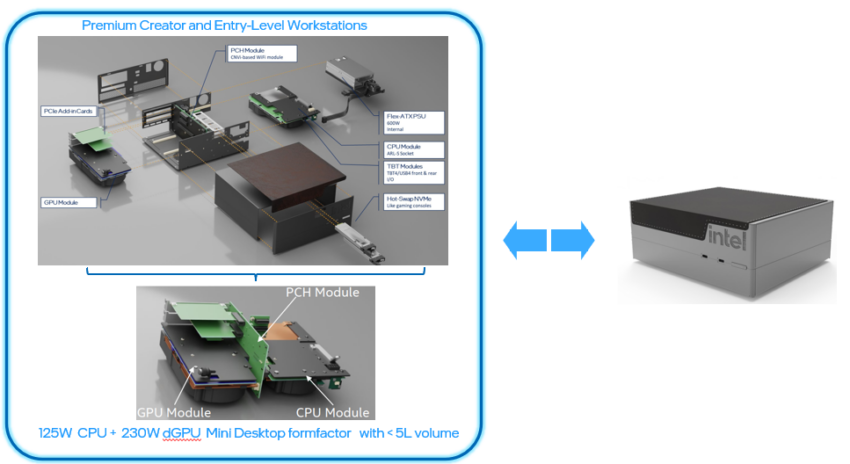

The I/O boards for Premium Modular designs are compatible across fanless Thin & Light (10W) and fanned models (20W single fan, 30W dual fan, Wi-Fi-only SKU). Designed for usability, repairability, and serviceability, Intel’s approach features removable CPUs, SODIMM memory, and GPUs on slide rails. For mini-PCs, hot-swappable M.2 modules enable easy GPU and processor upgrades in a plug-and-play fashion.

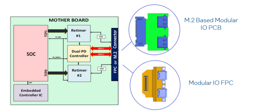

Intel also introduces subsystem-level replaceable modules, like Type-C connectors on FPC and M.2 PCBs, reducing repair costs and simplifying fixes. While modular mini-PCs are easier to design than modular laptops, both extend lifespan and reduce e-waste with upgradable, repairable components.

Thunderbolt post-channel modularity offers a potential solution for improving repairability by adding another layer of modularity.
