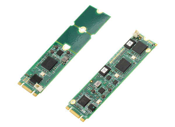

Kneron AI Edge Computing Modules with Kneron KL720 NPU is an innovative on-device edge AI solution that works seamlessly with cloud-based AI. The modules implement Kneron's Reconfigurable Artificial Neural Network (RANN) technology that adapts in real-time to audio, 2D, or 3D recognition applications while also being compatible with mainstream AI frameworks and convolutional neural network (CNN) models.
Kneron AI Edge Computing Modules with Kneron KL720 NPU is an innovative on-device edge AI solution that works seamlessly with cloud-based AI. The modules implement Kneron’s Reconfigurable Artificial Neural Network (RANN) technology that adapts in real-time to audio, 2D, or 3D recognition applications while also being compatible with mainstream AI frameworks and convolutional neural network (CNN) models. The AI Edge Computing Modules are based on the KL720, permitting maximum power efficiency and performance for segments.
  • Kneron KL720 NPU
  • Single – Compliant to M.2 2242 B-key (USB2.0 or USB3.0 interface)
  • Dual – Compliant to M.2 2280 B-M key (PCIe interface)
  • Breakable PCB to support 3 sizes: 2242, 2260 and 2280
  • Support 620 x 620, higher resolution recognition
Specifications
  • 1.4TOP/s NPU Performance
  • 128MB LPDDR3 memory
  • Operating temperature of 32°F to 122°F (0°C to 50°C with cooler 5m/s)
  • Storage temperature 32°F to 158°F (0°C to 70°C)
  • Operating humidity 0% to 90% relative humidity, non-condensing
  • Certification CE/FCC Class A
