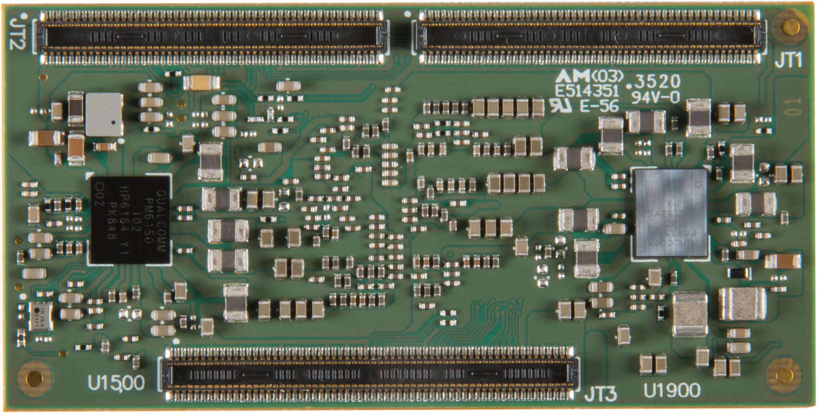

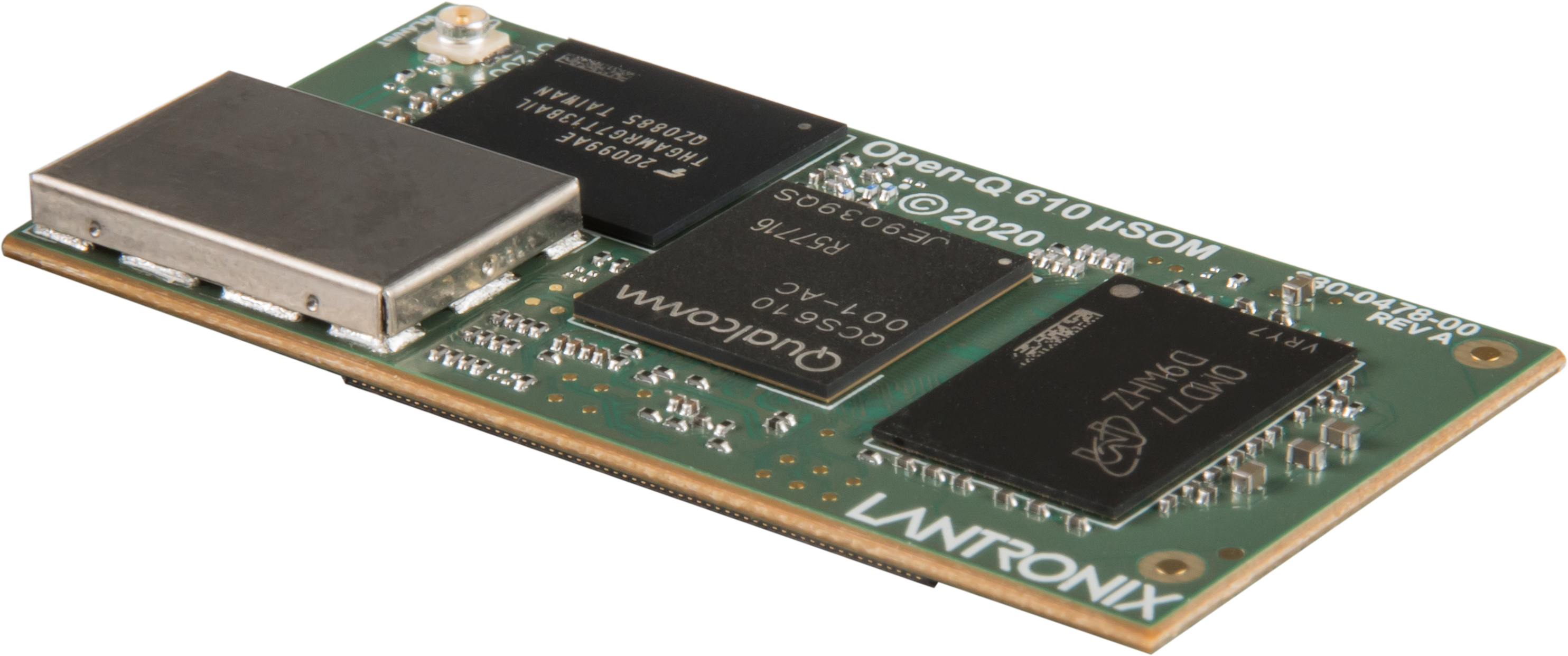

Lantronix’s Open-Q™ 610 μSOM is an ultra-compact (50mm x 25mm) production-ready SOM based on the powerful QCS610 SoC, with built-in Neural Processing Engine for on-device edge AI capabilities. Aimed at connected visual intelligence applications, with advanced built-in image sensor processing such as staggered HDR, lens de-warp, dual camera stitching, and image de-fog, the 610 μSOM is the ideal platform for your next smart camera product. Available with a full-featured development kit for ease of evaluation and POC development, the platform is supported by a Yocto Linux SDK with Qualcomm optimizations, GStreamer audio/video framework, and AI support for TensorFlow Lite and Qualcomm SNPE.

The Open-Q 610 μSOM follows other 50 x 25mm Intrinsyc μSOM modules such as Snapdragon 845 based Open-Q 845 uSOM. The Open-Q 610 μSOM ships with 2GB LPDDR4x and 16GB eMMC. The module integrates a native GbE controller and a Qualcomm WCN3980 module with dual-band 802.11a/b/g/n/ac and Bluetooth 5.x. Media interfaces include 3x 4-lane MIPI-CSI, 4-lane MIPI-DSI, DP 1.4 with Type-C support, and SLIMBus, SoundWire, and MI2S audio. Other I/O includes USB 3.1 and 2.0 plus SD, UART, I2C, SPI, and GPIOs. The 3.7V module is equipped with a PMIC.

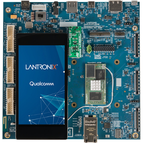

The companion Open-Q 610 Development Kit is a full-featured platform with available software tools, documentation, and optional accessories. It delivers everything required to immediately begin evaluation and initial product development. The development kit integrates the production-ready Open‐Q 610 µSOM with a carrier board, providing numerous expansion and connectivity options to support the development and testing of peripherals and applications. The development kit, along with the available documentation, also provides a proven reference design for custom carrier boards, providing a low-risk fast track to market for new products. The Open-Q 610 μSOM Development Kit is equipped with a single GbE, USB 3.1 Type-C, USB 2.0 host, and micro-USB serial debug ports. Available also is a dedicated DP 1.4 port that can be deactivated when running the Linux SDK.
There is no price available for the open-Q 610 μSOM. However, the Open-Q 610 μSOM Development Kit is available for pre-order at $995, with shipments due in November. More information about specification and documentation can be found on the Lantronix announcement, Open-Q 610 μSOM and Open-Q 610 μSOM Development Kit product pages, with the latter showing a shopping link.
