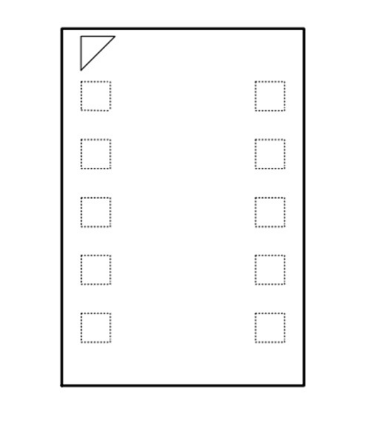

The MAXM17625 and MAXM17626 modules are housed in a low profile, compact 10-pin, 2.6mm x 2.1mm x 1.3mm, uSLIC package.
