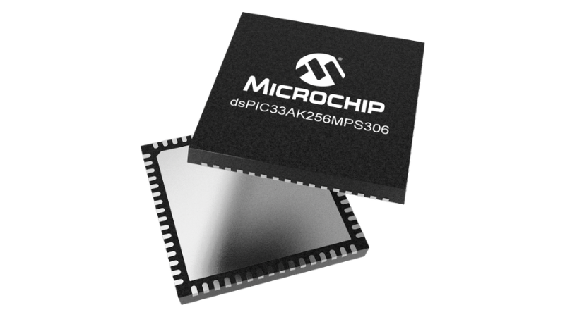

Microchip has expanded its dsPIC33A DSC family with the dsPIC33AK256MPS306
Microchip has expanded its dsPIC33A DSC family with the dsPIC33AK256MPS306. Image used courtesy of Microchip Technology
The dsPIC33AK256MPS306 Digital Signal Controller (DSC)
The dsPIC33AK256MPS306 is built on a 200 MHz 32-bit core that includes a double-precision floating point unit. This computational capacity is paired with an extensive suite of analog and timing peripherals. Specifically, the controllers feature high-resolution pulse-width modulators with 78 ps timing accuracy. This precision is critical for controlling modern wide-bandgap semiconductors like silicon carbide and gallium nitride. These power devices often operate at high switching frequencies, requiring fine timing resolution to maintain system efficiency and stability.
To support high-speed feedback loops, the devices integrate multiple 40 MSPS 12-bit analog-to-digital converters and 5 ns high-speed comparators. On-chip digital-to-analog converters with slope compensation are also included. This high level of integration is intended to reduce designers’ total bill of materials by eliminating the need for many external components while enabling faster, more deterministic control loops in DC/DC converters and sensing applications.

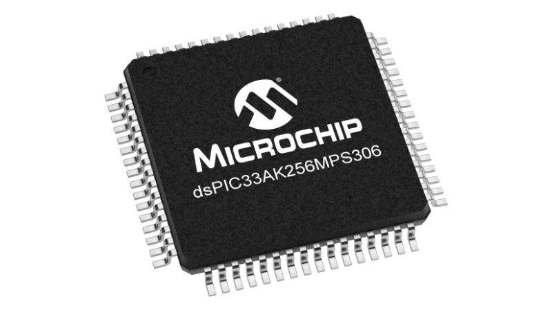

The dsPIC33AK256MPS306 is built on a 200 MHz 32-bit core. Image used courtesy of Microchip Technology
