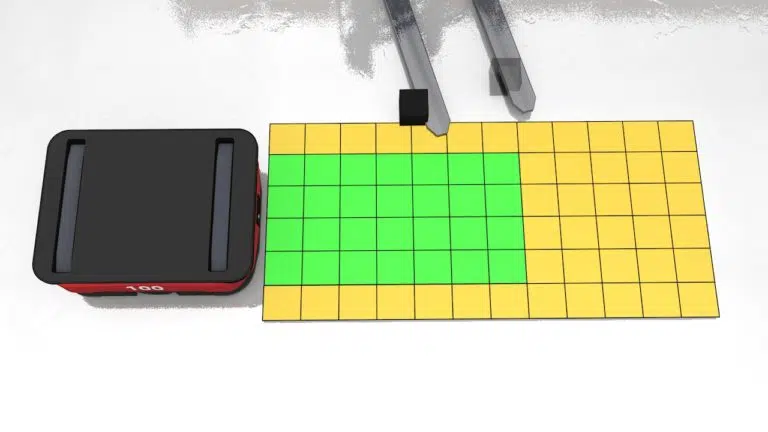

Toposens 3D Collision Avoidance System illustrated: Detection of forklift forks in warning zone and stopping zone

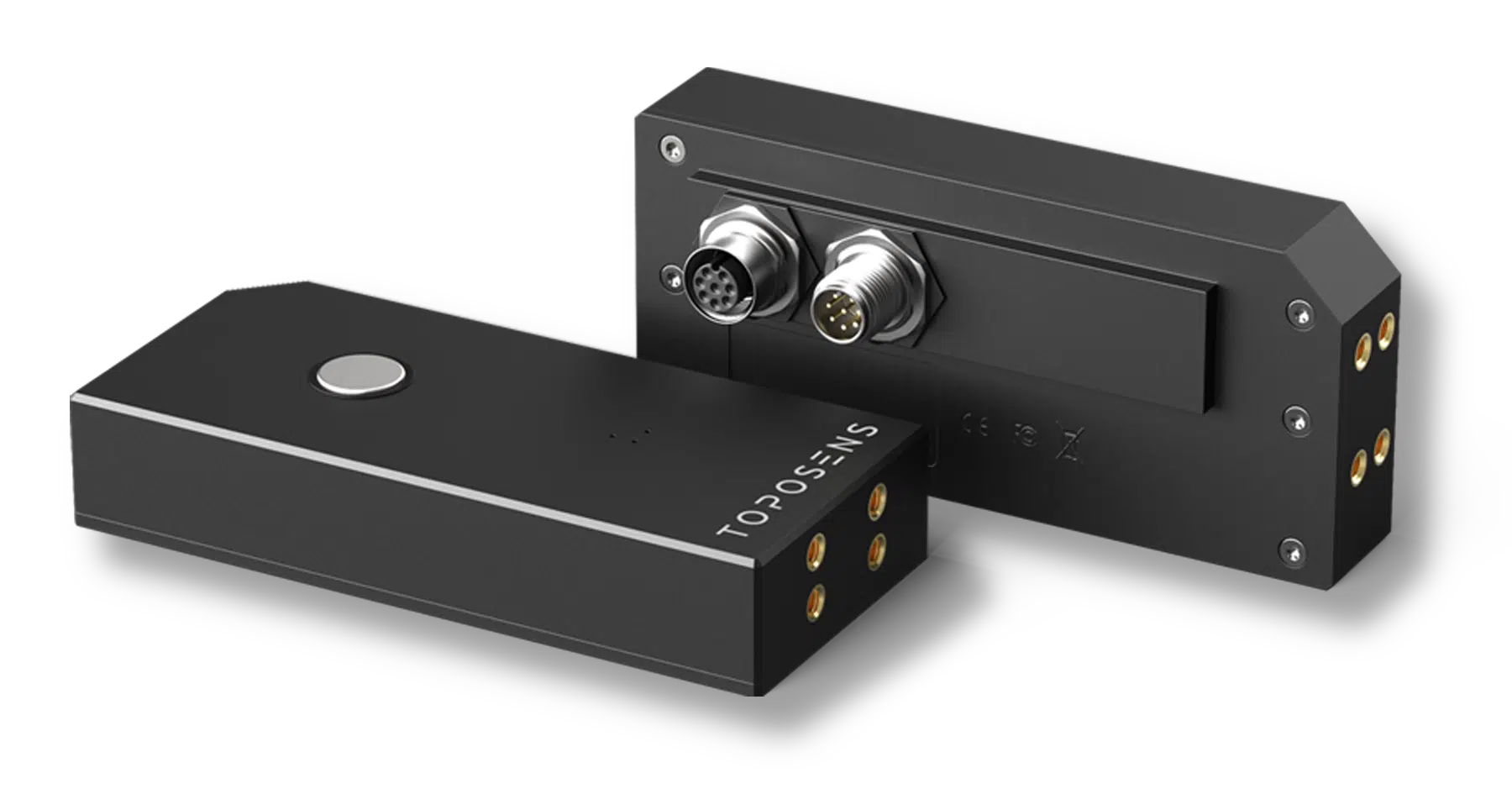

Based on the principle of echolocation as seen in bats, Toposens ECHO ONE® compensates the drawbacks of optical sensors through sound-based triangulation in combination with sophisticated noise-filtering software. This in turn delivers robust 3D data output in real-time for each obstacle detected within the fully adjustable warning- and stopping zones. What’s more, the zones can both be set to dynamically follow a mobile robot taking a left- or right turn and adjust to the speed of the vehicle.
The sensor sends the obtained data (echo reflections perceived by three microphones) in a 3D point cloud format to the Toposens PROCESSING UNIT which is equipped with an easy-to-configure advanced 3D collision avoidance software. From there, depending on which 3D zone violations are detected, the Toposens PROCESSING UNIT triggers either a “slow down” or “stop” command to the mobile robot’s CPU. When no zone violations are detected, the mobile robot drives on.
