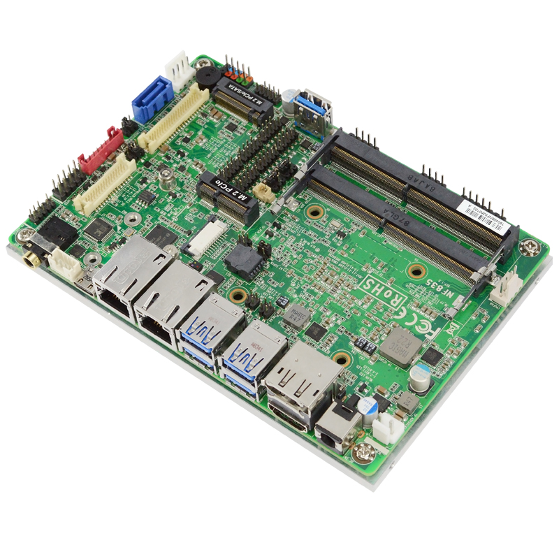

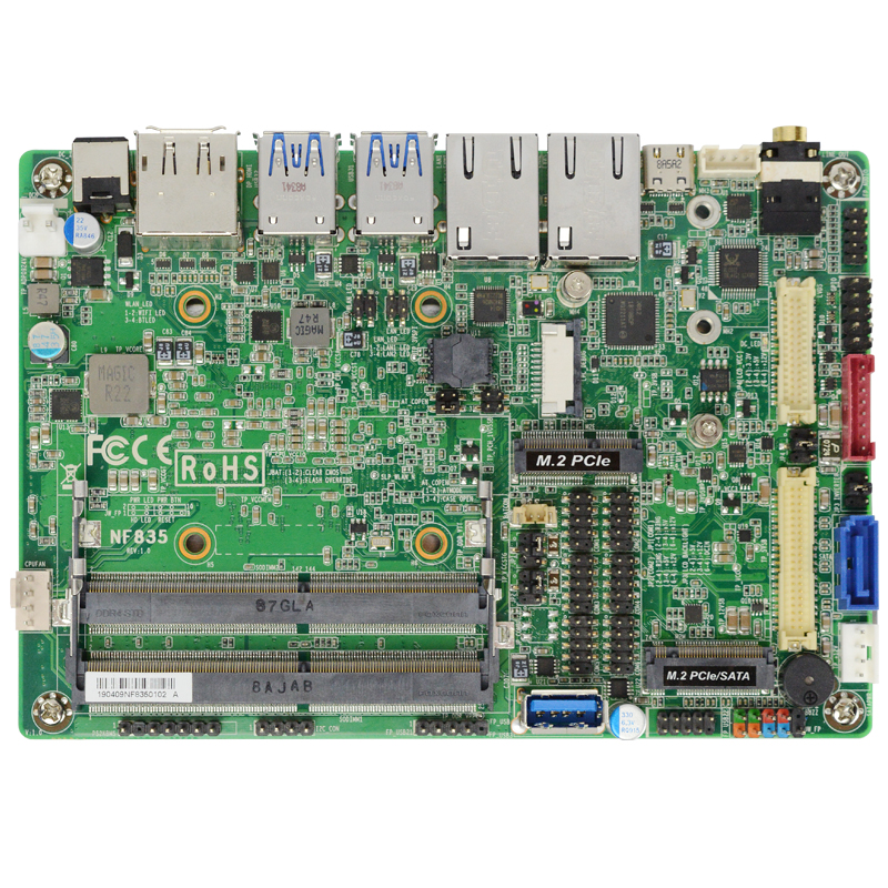

The JETWAY JNF835 is 3.5” form factor board adopts the Intel® Whiskey Lake-U i5-8365UE Processor. The board supports two SO-DIMM DDR4 2400Mhz memory, up to 32GB.
The JETWAY JNF835 is 3.5” form factor board adopts the Intel® Whiskey Lake-U i5-8365UE Processor. The board supports two SO-DIMM DDR4 2400Mhz memory, up to 32GB. Featuring the integrated Intel® Gigabit Ethernet controller, the JNF835 offers two 10/100/1000Base-TX Ethernet devices for network transmission. One SATAIII (6Gb/s) interface and one M.2 M-key offer storage devices. One four USB3.1 Gen.2 ports, two USB3.1 Gen.2 ports for Type C and Internal Vertical connector, three USB2.0 ports and six COM ports provide versatile expansion. The M.2 E-key can support WIFI/3G/4G and Intel CNVi interface. The JNF835 offers one HDMI1.4 port, one DP1.4 port, one eDP port and one 24-bits Dual CH LVDS which can support 3 independent displays. Because of the above features, JNF835 is suitable for Digital Signage, Industrial PCs, Factory Automation, IOT Solution applications.
  • Intel® Whiskey Lake-U i5-8365UE Processor (TDP 15W)
  • 2* DDR4 2400MHz SO-DIMM up to 32 GB
  • 2* 10/100/1000 Base-TX Ethernet Ports
  • 1* HDMI, 1* DP, 1* eDP, 1 * 24-bits Dual CH LVDS
  • 6* COM (COM1 support RS232/422/485), 4* USB3.1 Gen.2, 2* USB3.1 Gen.2 (Type C & Vertical type) & 3* USB2.0
  • 1* M.2 M-key (2242/2260/2280)support NVMe, 1* M.2 E-key (2230 w/ CNVi)
  • 1* SATA III (6Gb/s)
  • Support onboard TPM 2.0 (option)
