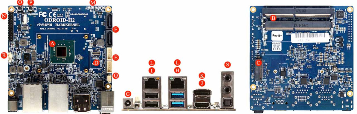

ODROID H2+ Board view
The Intel J4115 clocks at 1.8GHz, and offers a Turbo Boost speed of up to 2.5GHz or 2.3GHz in multi-thread mode. This is a huge difference from the earlier J4105 that clocked at 1.5GHz/2.3GHz when the H2 was launched. The J4115 offers Intel UHD Graphics 600 and a 10W TDP, just like the J4105. The SBC is compatible with Ubuntu 20.04 image, Linux distros, and Windows 10.
Hardkernel says:
“We decided to call this new iteration of the H2 the ODROID H2+ (ODROID H2-plus). Accordingly the board revision code is REV-B+ (while the previous production batch was REV-B).” They continue “The additions described above being put aside the H2 and H2+ are 100% forward hardware and software compatible, including the same board size and overall configuration. Everything you do on the H2 from a hardware viewpoint can be done exactly the same way on the H2+, including converting the M.2 NVMe slot to PCIe2 x4 with a 3rd party adapter cable, connecting the H2+ to a 1 Gbe or 2.5 Gbe switch or other SBC or PC NIC, using the GPIO, etc. The ODROID H2+ just happens to offer more!”
The last year’s RevB model featured some upgrades to the PCIe-to-SATA bridge, SATA power, NVMe I/O, and BIOS. The upgrade is the major difference between the H2+ and the H2. The H2+ enables 2x SATA 3.0, HDMI and DP, 4x USB (2x 3.0), and an M.2 slot for NVMe storage. Additional features include an RTC and a heatsink that supports 70°C temperatures at full load. The Odroid-H2+ is available for $119 plus shipping without RAM, storage, or power adapter. “We hope you understand that the price increases from $111 to $119 due to the hardware components upgrades.” Says Hardkernel. They conclude “We expect to continuously manufacture the ODROID H2+ with no interruption of the CPU production from Intel.”
