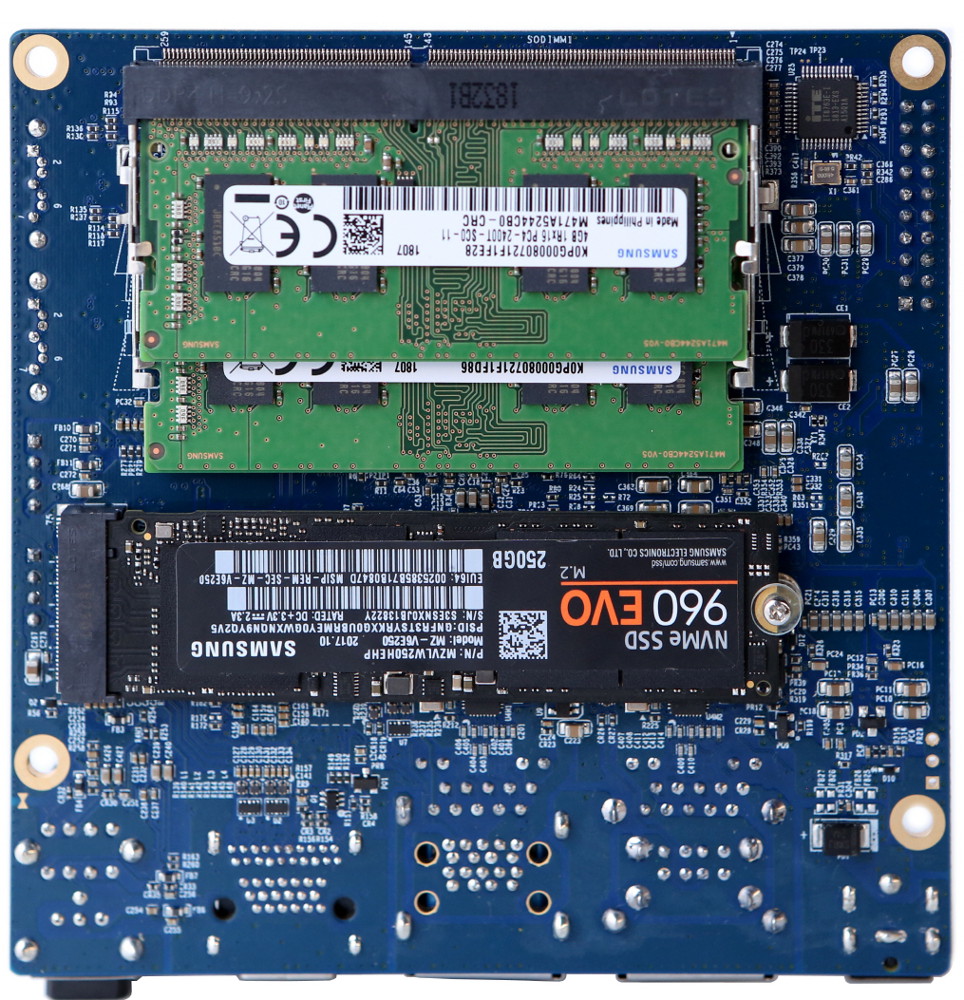

ODROID H2 loaded with 8GB RAM and an NVMe SSD
