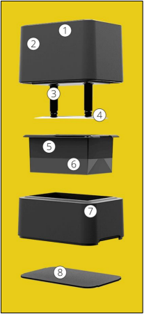

ONO has the following components:
  1. LED interface – The logo on the top of the printer flashes to show the status of the print
  2. Motor housing – The top part of the printer which controls the raising of the build plate
  3. Z-axis actuators – Drive gears connected to the motor and the build plate
  4. Build plate – Aluminum plate where the part adheres
  5. Resin tank – Removable tank where resin is poured prior to printing
  6. Printing film – Thin, clear film which seals the resin tank
  7. Adjustable base – The base can be raised or lowered so that the phone screen will sit flat against the printing film.
  8. Phone pad – A soft pad that helps level phones with protruding cameras
