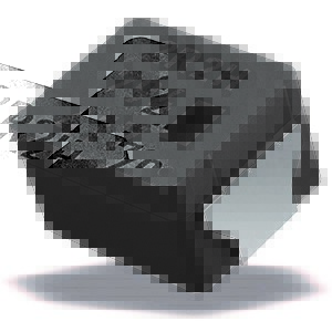

Panasonic’s ETQP Series metal-composite type power choke coils offer exceptional robustness for use in harsh automotive and industrial applications. AEC-Q200 qualified, they are ideal for use as noise filters in drive circuits, and in step-down and step-up circuits in DC-DC converters, voltage regulators and buck-boost converters.
The ETQP Series inductors are notable for their high current capability, high heat resistance and excellent thermal stability. Made with a high temperature-capable resin material, the ETQP Series inductors are rated for an operating temperature of up to 160°C.
ETQP Series | Available now from Future Electronics – You can find full pricing and delivery information here
Other key features of these Panasonic power inductors include:
  • Vibration resistance of 10g-30g
  • Up to 40% smaller than equivalent ferrite-type inductors
  • High tolerance of thermal shock when cycle-tested at -40°C to 150°C
  • Metal-composite core with magnetic shielding
  • Non-hard saturation
In industrial equipment, the ETQP series devices are suitable for:
  • Automation
  • Servers
  • LED drivers
  • Power supply modules
