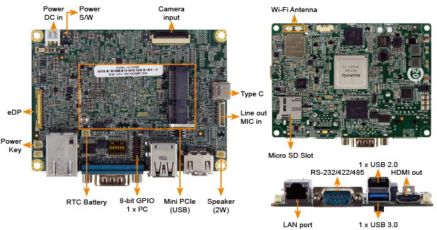

Hyper-RK39 front view
Hyper-RK39 is IEI’s pioneer Arm-based SBC. It is the only one currently available. The RK3399 is equipped with dual Cortex-A72 cores at up to 1.8GHz and four -A53 cores at up to 1.5GHz. Available also, is a Mali-T864 GPU, which according to IEI offers 45 percent better performance than the Mali-T628. IEI supports the SoC with Ubuntu 16.04 and Android 7.1, soon to be upgraded to 8.1. This allows the developer to develop your personal application to cater for a large number of demands.
The features of the RK3399, is much like the RICO-3399 features, with 2GB LPDDR3, 16GB eMMC, a microSD slot, and 4K ready HDMI 2.0 and eDP ports with dual simultaneous display support. A standard GbE and WiFi/Bluetooth is available, as well as USB 3.0, 3.0 Type-C, USB 2.0, and serial ports. A mini-PCIe slot is dedicated to an optional LTE module. Although the Hyper-RK39 lacks the Aaeon board’s optional NFC and GPS, you get a MIPI-CSI connector with an optional camera, as well as a speaker header with an optional 2W speaker.
The Hyper-RK39 is also equipped with a watchdog timer, RTC, audio and I2C headers, and 8-bit GPIO. It has an identical temperature range as the RICO-3399, except the highs and lows, are 10 degrees lower at -10 to 50°C. The IEI HYPER-RK39 Pico-ITX SBC has a very compact design.

  • Processor — Rockchip RK3399 (2x Cortex-A72 and 4x Cortex-A53 cores @ up to 1.8GHz); Mali-T864 GPU
  • Memory: 2GB LPDDR3-1866 RAM, 16GB eMMC flash, MicroSD slot
  • Wireless: 802.11ac with Bluetooth 4.1, Optional WiFi antenna, Mini-PCIe slot for optional LTE (with optional antenna and SIM slot)
  • Networking — Gigabit Ethernet port (Realtek RTL8211E)
  • Media I/O: HDMI 2.0a port for up to 4Kx2K @ 60Hz with HDCP 2.2, eDP header at up to 4Kx2K @ 60Hz, Optional eDP touchscreen (11.1-inch, 1920 x 1080, 280 nits), Dual display support, MIPI-CSI connector with optional 2592 x 1944 camera module, Audio line in/out header, 2W speaker header with optional speaker
  • Other I/O: USB 3.0 port, USB 3.0 Type-C port (for OS update), USB 2.0 port, RS-232/422/485 port, RS-232 header, 8-bit GPIO, I2C interface
  • Other features — Watchdog timer; RTC with battery slot; optional cables
  • Power — 12V DC header (AT/ATX)
  • Operating temperature — -10 to 50°C
  • Weight — 80 g
  • Dimensions — 100 x 72mm; Pico-ITX form factor
  • Operating system — Ubuntu Linux 16.04; Android 7.1 (soon 8.1)
