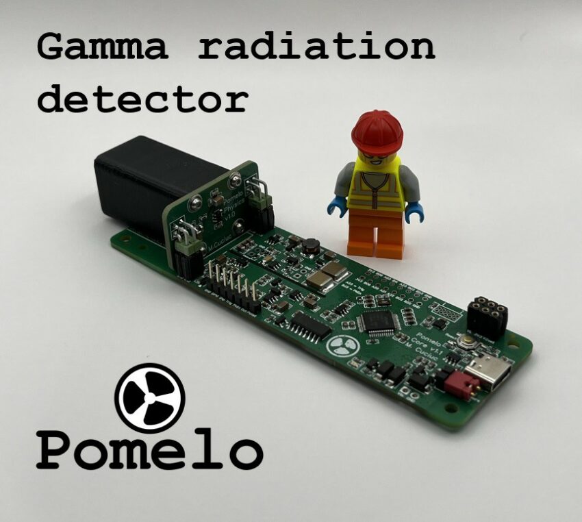

Pomelo is an innovative radiation detector tailored for hobby-level gamma spectroscopy, designed to be both accessible and versatile. Developed to provide a complete low-power gamma-ray spectrometer, Pomelo can function independently or be seamlessly integrated into other projects, offering a broad range of applications for enthusiasts and developers alike.
Pomelo Gamma Radation Detector
The Pomelo gamma spectroscopy module is built around a set of well-defined requirements, prioritizing low cost and low power consumption. The target is to keep the component cost below 150 euros, making it an affordable option for hobbyists and educational purposes. At its core, the module utilizes a commercial off-the-shelf (COTS) scintillator and a silicon photomultiplier (SiPM), ensuring reliability and performance.
The detector assembly, branded as Pomelo Physics, comprises a CsI(Tl) scintillator measuring 10mm x 10mm x 30mm from OST Photonics and a Broadcom AFBR-S4N44P014M SiPM. This combination effectively detects gamma rays within an energy range of 50 keV to 3 MeV. To maintain accuracy and protect the SiPM from stray light, the scintillator is housed in a 3D printed dark box. Additionally, the module includes a Texas Instruments TMP126 temperature sensor to provide temperature compensation, ensuring consistent performance across varying environmental conditions.

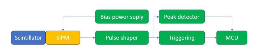

Block Diagram
Block Diagram
Pomelo Core, the accompanying electronics module, integrates several features that enhance its functionality and ease of use. It includes a bias supply, an analog front end, and digital electronics, all essential for effective gamma ray detection and data processing. One of the standout features of Pomelo is its versatile connectivity options. The module supports USB connectivity (CDC) for data dumping to a terminal, making it straightforward to interface with laptops and other USB-equipped devices. Additionally, it features UART for interfacing with external microcontroller units (MCUs), such as Arduinos or Raspberry Pis. The onboard level shifter on the UART lines ensures compatibility with both 3.3V and 5V systems.
