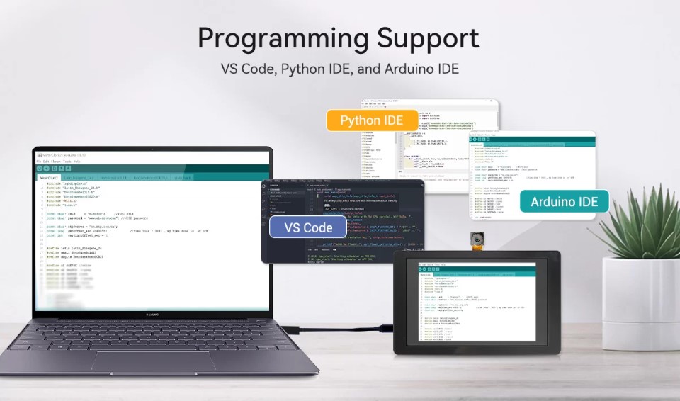

It is compatible with Python, MicroPython, and Arduino and facilitates the creation of ESP-IDF and Arduino IDE. Additionally, it supports LVGL, the most widely used free and open-source embedded graphics library for building stunning user interfaces for any MCU, MPU, and display type.

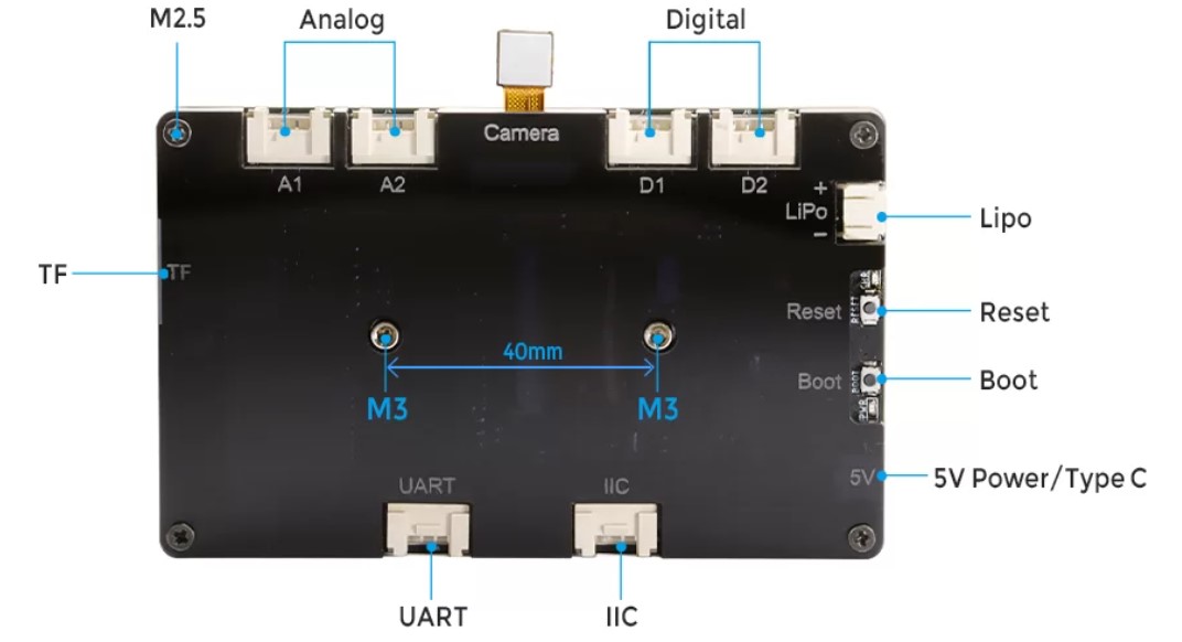

Pinout
The entire terminal is encircled by a flawless acrylic shell, which enhances the beauty of the entire product. It can be mounted to the wall or a PLC rail. The wiki page gives detailed information.
