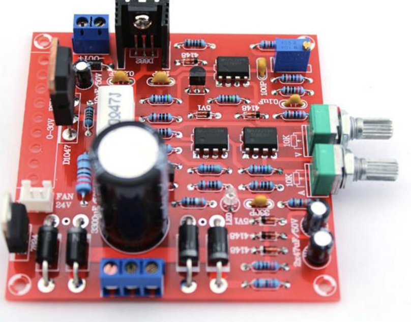

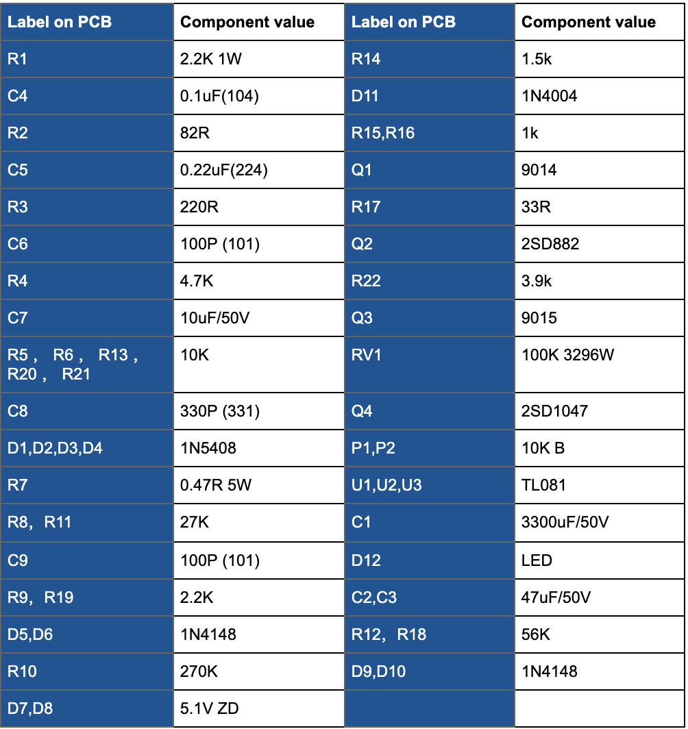

Assembling the power supply Kit
The assembly process for the power supply kit is fairly straight forward. The components in the kit are through-hole type, so all you will need to do is find where each component is meant to be on the board, place it, and solder it. Before soldering, it is important to ensure the orientation of the component is correct, especially for components like diodes and ICs, as placing them wrongly could damage the component itself or the whole board. To make the component placing easy, a table showing the labels on the PCB and the value of the component to be placed is provided below.
If you are not familiar with things like color coding for resistors, it might be helpful to have a meter with you to check the value of the resistors and confirm orientations before soldering. For ICs, you can look up the pinout diagrams/datasheets.
With all the components mounted, the board should look like the image below;

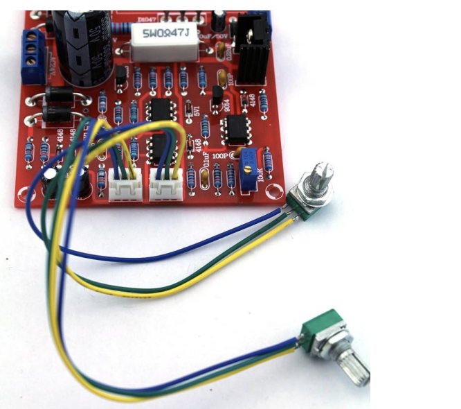

For the voltage and current adjustment potentiometers, you can solder them directly on the PCB as shown above, but to allow more flexibility for your enclosure, you should connect them to the board through socket and jumper wires as shown below.
The potentiometer tagged with A is the current limit potentiometer and V is the voltage potentiometer. In place of the regular potentiometers, for easier and more accurate adjustments, you may replace the voltage potentiometer that came with the kit, with a 10K multi-turn wire-wound potentiometer.
With all the components soldered on the PCB, one last thing we need to do to test the power supply module is to install a cooling fin of considerable size, insulated from the circuit, on Q4 (D1047). A lot of heat will be generated at this end of the circuit and it could lead to a breakdown if it is not properly handled. If the cooling fin is not big enough, you can make use of a cooling fan. The 24V socket on the board was placed there for this purpose. After installing the cooling fin and fan, the board should look like the image below.
Go over the connections once again though to ensure everything is as it should be. With this done, the Power Supply is ready to go. We can now move to the other parts of the project.

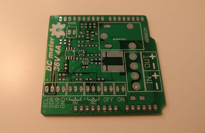

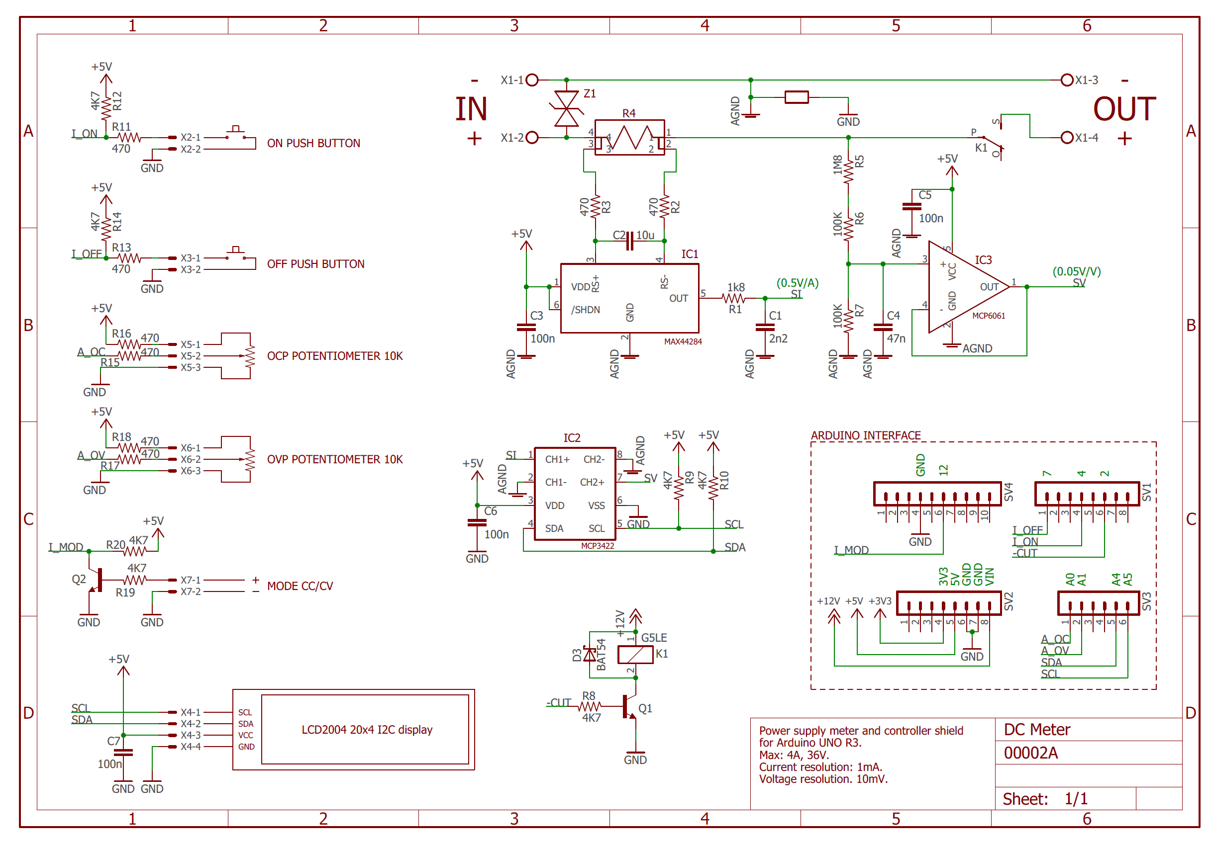

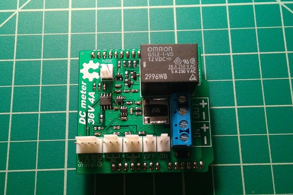

Build the Metering Shield
Up next is the metering shield. As mentioned during the introduction, the metering shield helps digitize the controls and provides visual feedback to the user. It also implements the shutdown overvoltage and overcurrent features which disconnects the load via a relay.
As the name implies, the metering circuit was designed as a shield, compatible with all boards that have the layout and dimensions of the R3 version of the Arduino Uno.  Due to the shielding nature, it was implemented on a PCB which was designed using Eagle CAD.
The schematics below show how the components are connected:
All design files including, schematics, PCB, and Gerber files are attached under the download section at the bottom of the page. This makes it easy for those who may like to make changes to the design and those who want to just ship the Gerbers off to fabricators and replicate the exact design.
An image of the PCB after production is provided below.

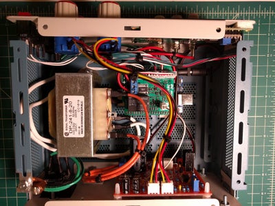

After assembly, the shield should look like the image below;

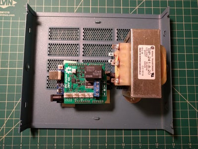

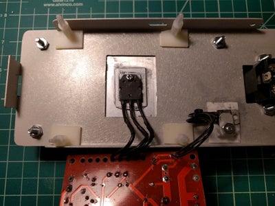

With the metering shield and the Power Supply all in place, its time to couple them together to create the Lab Power Supply.

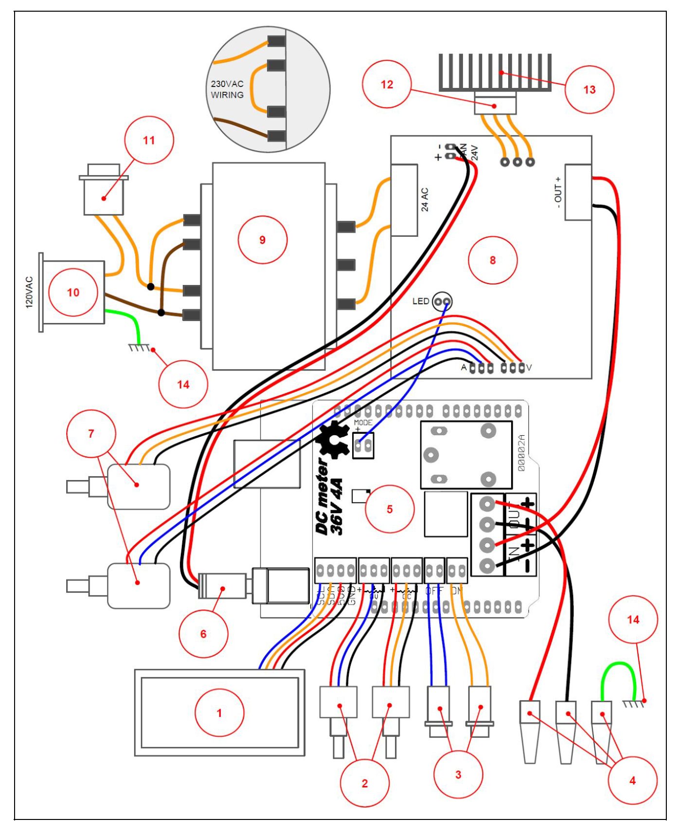

Schematics
Connect the power supply, the metering shield, the Arduino, the display, and other parts of the system together as shown in the schematics below.
The schematics is labeled to make it easy to identify which component goes where. A lookup table for the labels on the schematic is attached under the download section.
AC power source to the system is feed via the transformer which steps the voltage down to 24Vac. It is important to note that the input AC Voltage to the Power Supply Module is 24v and ensure you use a transformer which is rated for such. The system might behave in an unstable manner if a voltage is higher than this. The output of the Vkmaker power supply circuit kit is connected to the IN terminal block of the metering shield and the OUT terminal block of the metering shield goes directly to the binding posts of the Lab power supply. The Arduino is powered over its DC power jack, with supply from the 24V terminal on the power supply.

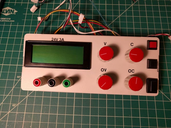

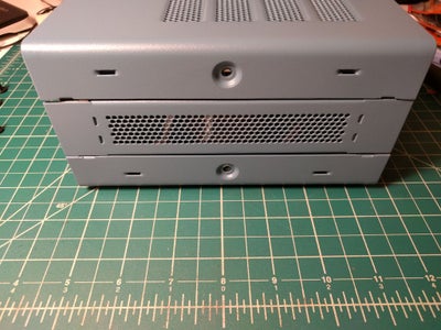

Enclosure
Consistent with Danielrp’s projects, the enclosure for this project is a beauty to behold. It is based on an aluminum enclosure from Cheval (their standalone SA-Series enclosure).
The SA-Series Enclosure

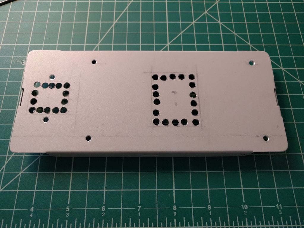

In the absence of a router to modify the enclosure to suit the needs of the power supply, the old way of cutting, trimming with file, and using transfer letters for the text, was adopted. An Inkscape file with the stencil used in cutting the front panel is attached to the zip file under the download section. You can print this and use it to trace out your design on the front panel or cut using a router.
Stencil for Front Panel
The front panel after cutting and trimming should look like the image below.
Front Panel After Cutting

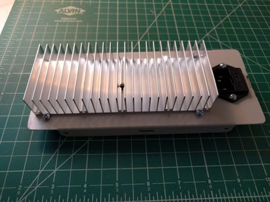

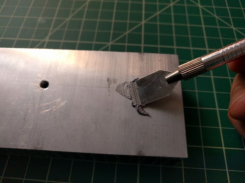

The back panel of the enclosure also requires modification so the heat sink and the IEC Connector for Power could be mounted. To achieve this, follow the steps below;
1. Mark the position of the heatsink, including the hole for the power transistor and the position of the holding screws.
2. Mark the hole for accessing the heatsink from the interior of the power supply enclosure, I have used the insulator as a reference.
3. Mark the hole for the IEC connector.
4. Drill the contour of the shapes.
5. Drill the holes for the screws.
6. Cut the shapes with cutting pliers.
7. Trim the shapes with a file.
Back Panel after cutting and trimming
It is important to reiterate the importance of the heatsink at this point, as the power supply circuit is not self-protected against overheat. According to the datasheet the 2SD1047 transistor has a junction to case thermal resistance of Rth-j,c = 1.25ºC/W, as such, before buying a heat sink you must take into consideration its thermal resistance and evaluate its suitability based on other factors. A guide to understanding how heat sink calculations work is provided here. but for the sake of this project, this heat sink, with a thermal resistance of  Rth-hs, air = 0.61ºC/W, was used and it seemed to be good enough after calculations.

To start with the front panel, follow these steps to position the components;
  • Strip out a multiconductor cable from scrap to get cables.
  • Build the “Molex connector”, wire and shrinkable tube assembly for potentiometers, pushbuttons, and LCD. Remove any protuberance in potentiometers.
  • Remove the pointer ring of knobs.
  • Cut the rod of potentiometers to the size of the knob. I have used a piece of cardboard as a gauge.
  • Attach the pushbuttons and power button.
  • Assemble the potentiometers and install the knobs, the multiturn potentiometers have a ¼ inch shaft and the one turn models have a 6mm shaft. You can use washers as spacers to trim the distance of potentiometers.
  • Screw the binding posts.
  • Put a double-sided tape in the LCD and stick it to the panel.
  • Solder the positive and negative wires to the binding posts.
  • Assemble the GND terminal lug in the green binding post.
    Front Panel After Assembly
With the front panel in place, arrange the back panel with the heat sink following the steps below;
1. While the paint on the enclosure is a good thermal isolator, you can add some heatsink grease to increase the heat transfer from the heatsink to the enclosure.
2. Screw the heatsink to the back panel.
3. Assemble the IEC connector.
4. Position the adhesive spacers using the power supply kit circuit.
5. Screw the power transistor and the insulator, there must be thermal grease in each surface.
6. Assemble the 7812 for powering the Arduino, it should face the case to allow heat dissipation, using one of the screws that hold the heatsink. A plastic washer like this http://www.ebay.com/itm/100PCS-TO-220-Transistor-… could also be used but the project used the same insulator as the power transistor and a bent piece of the case.
7. Finally, Wire the power transistor and the 7812 to the power supply circuit.
Finally, assemble the transformer, DC meter, Arduino + metering shield, and other components, in the enclosure. You can follow these steps to get that done;
  1. Mark and drill the holes for the transformer.
  2. Assemble the transformer.
  3. Stick the adhesive legs of the enclosure.
  4. Stick the DC meter circuit using adhesive spacers.
  5. Scrape the paint to screw the GND lug.
  6. Build the mains voltage wire assemblies, all the terminations are 3/16” Faston. Shrinkable tubes were used to isolate the terminations.
  7. Cut the front part of the holder of the enclosure on the right side to get space for the power pushbutton.
  8. Connect all wires according to the assembly guide provided under the schematics section.
  9. Install the Fuse (1A).
  10. Put the output voltage potentiometer (the VO potentiometer), to the minimum CCW and adjust the output voltage the closest possible to zero volts using the multiturn fine adjusting potentiometer of the vkmaker power supply circuit.
  11. Close up the enclosure.
with this done, the Super Lab Power Supply is now ready for testing and usage.
