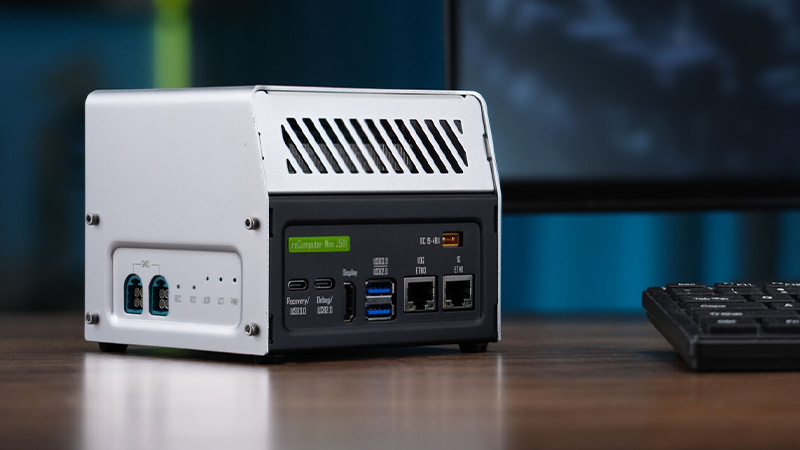

reComputer Mini J5011 Edge AI Computer

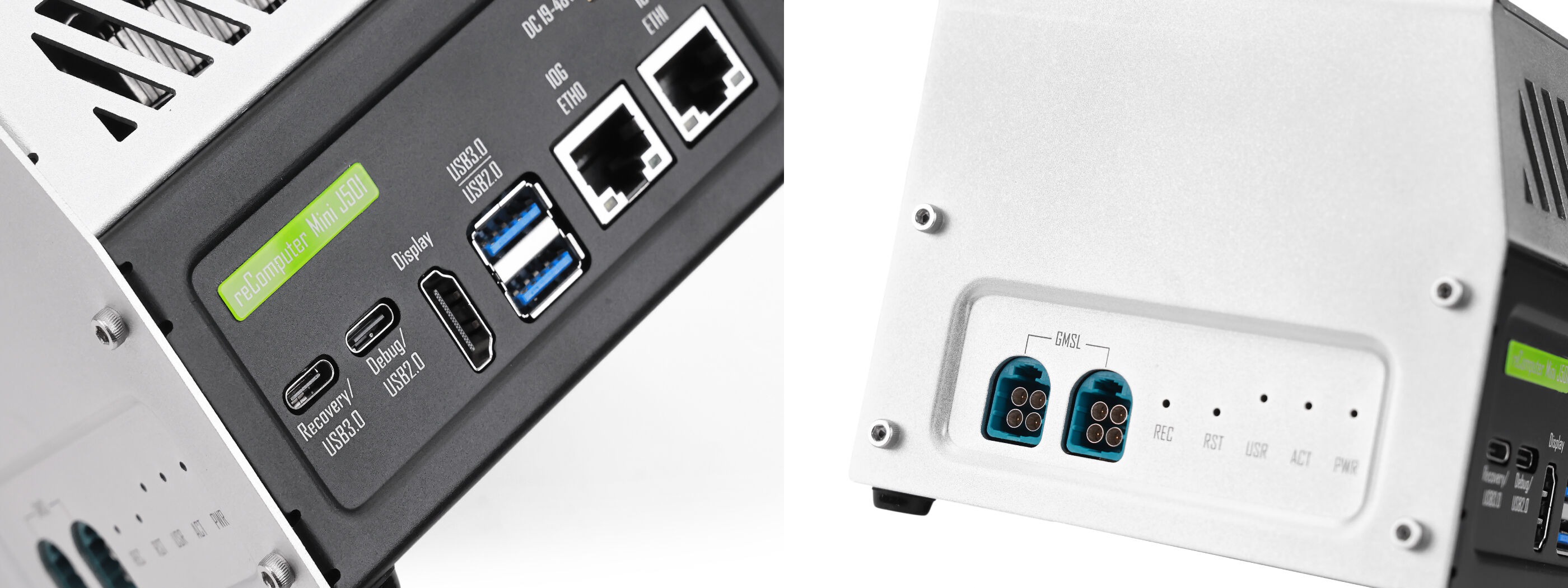

Seeed Studio has introduced the reComputer Mini J5011 with GMSL, an ultra-compact Edge AI Computer built around the NVIDIA Jetson AGX Orin 32GB module. The system delivers up to 200 TOPS of AI performance through 1,792 CUDA cores and 56 Tensor Cores, making it suitable for robotics, computer vision, autonomous navigation, and other demanding edge AI workloads.
The system measures just 119 × 119 mm in footprint and supports input voltages from 19V to 48V, with a maximum input of 54V. This design makes the J5011 useful for compact robots and 48V power systems. Its GMSL2 support can connect up to eight cameras, while 10GbE, Gigabit Ethernet, USB, CAN, RS-485, GPIO, and I2S provide the interfaces needed for robotics development. Seeed also offers the reComputer Mini J5012 with a Jetson AGX Orin 64GB module and up to 275 TOPS of AI performance.

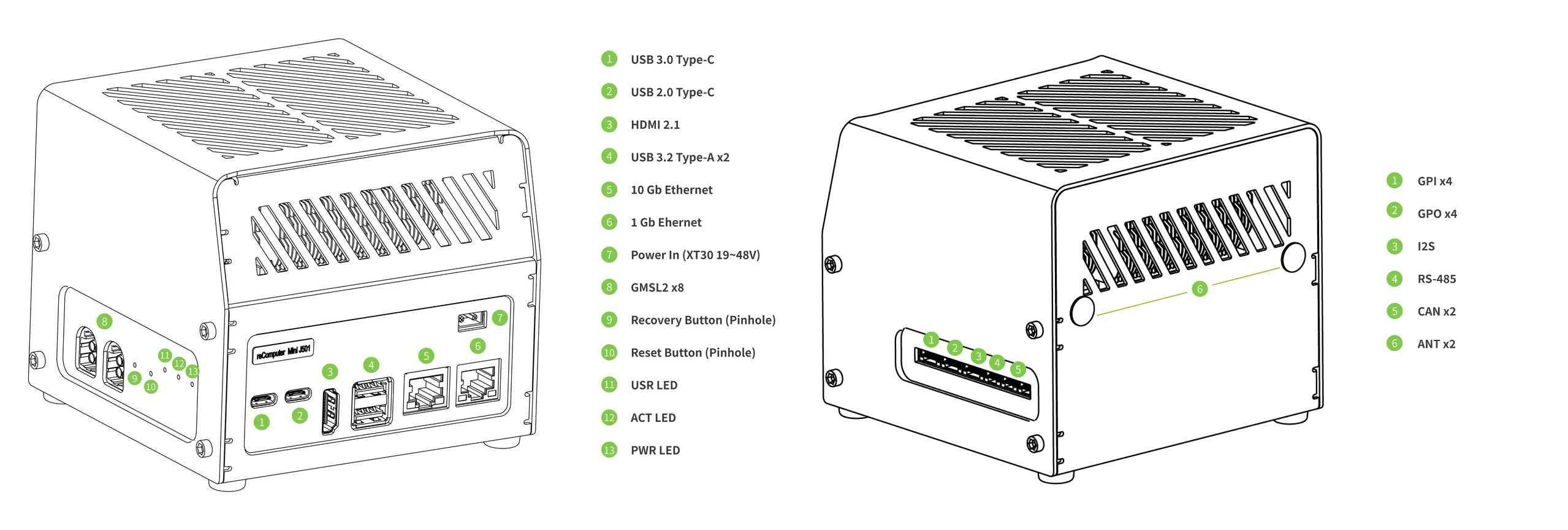

reComputer Mini J5011 Edge AI Computer Ports
reComputer Mini J5011 Specifications:
  • Module: NVIDIA Jetson AGX Orin 32GB
    • AI Performance: Up to 200 TOPS
    • CPU: 8-core Arm Cortex-A78AE @ 2.2 GHz
    • GPU: 1,792 CUDA cores, 56 Tensor Cores, up to 930 MHz
  • Memory: 32GB 256-bit LPDDR5, 204.8GB/s

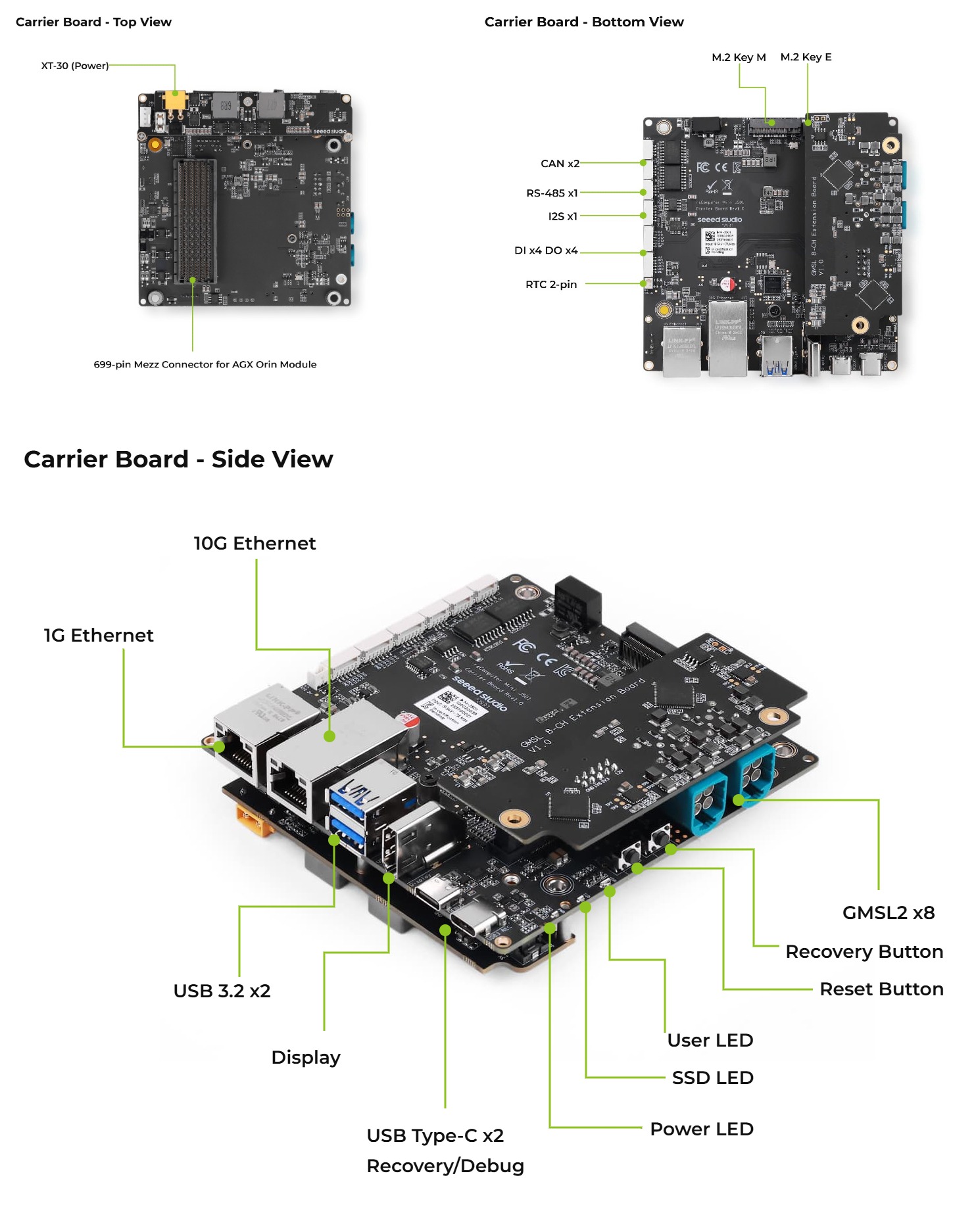

  • Storage: 64GB eMMC 5.1, 1× M.2 Key M slot for NVMe SSD, 128GB SSD included
  • Video:
    • Video Encoding: 1× 4K60, 3× 4K30, 6× 1080p60, or 12× 1080p30, H.265
    • Video Decoding: 1× 8K30, 2× 4K60, 4× 4K30, 9× 1080p60, or 18× 1080p30, H.265
  • Networking:
    • Ethernet: 1× 10GbE RJ45, 1× Gigabit Ethernet RJ45
    • Wireless: 1× M.2 Key E slot for Wi-Fi/Bluetooth module
    • RS-485: 1× isolated RS-485
  • USB: 2× USB 3.2 Type-A, 1× USB 2.0 Type-C debug, 1× USB 3.0 Type-C recovery
  • Camera: Up to 8× GMSL2 cameras via optional GMSL extension board
  • Compatible GMSL2 Cameras:
    • Sensing SG3S-ISX031C-GMSL2F: 1920 × 1536
    • Sensing SG2-AR0233C-5200-G2A: 1920 × 1080
    • Sensing SG2-IMX390C-5200-G2A: 1920 × 1080
    • Sensing SG8S-AR0820C-5300-G2A: 3840 × 2160
    • Orbbec Gemini 335LG: 3D
  • CAN: 2× isolated CAN
  • GPIO: 4× GPI and 4× GPO, 3.3V
  • I2S: 1× I2S, 3.3V
  • Display: 1× HDMI 2.1
  • Misc:
    • Fan: 1× 4-pin, 12V PWM fan connector
    • RTC: 1× 2-pin RTC connector
    • LEDs: 3× LEDs for PWR, ACT, and USR
    • Buttons: Reset and Recovery
  • Power:
    • Power: 19–48V DC via XT30 connector, maximum 54V input
    • Power Modes: 15W / 40W
  • Operating Temperature: -10°C to 60°C
  • Dimensions: 119 × 119 × 100 mm
  • Weight: 1.325 kg
  • Certification: RoHS, CE, FCC, KC, GB/T 2423 vibration test
  • Warranty: 2 years
reComputer Jetson Mini J501 Carrier Board Overview
reComputer Jetson Mini J501 Carrier Board Overview (click to zoom)
