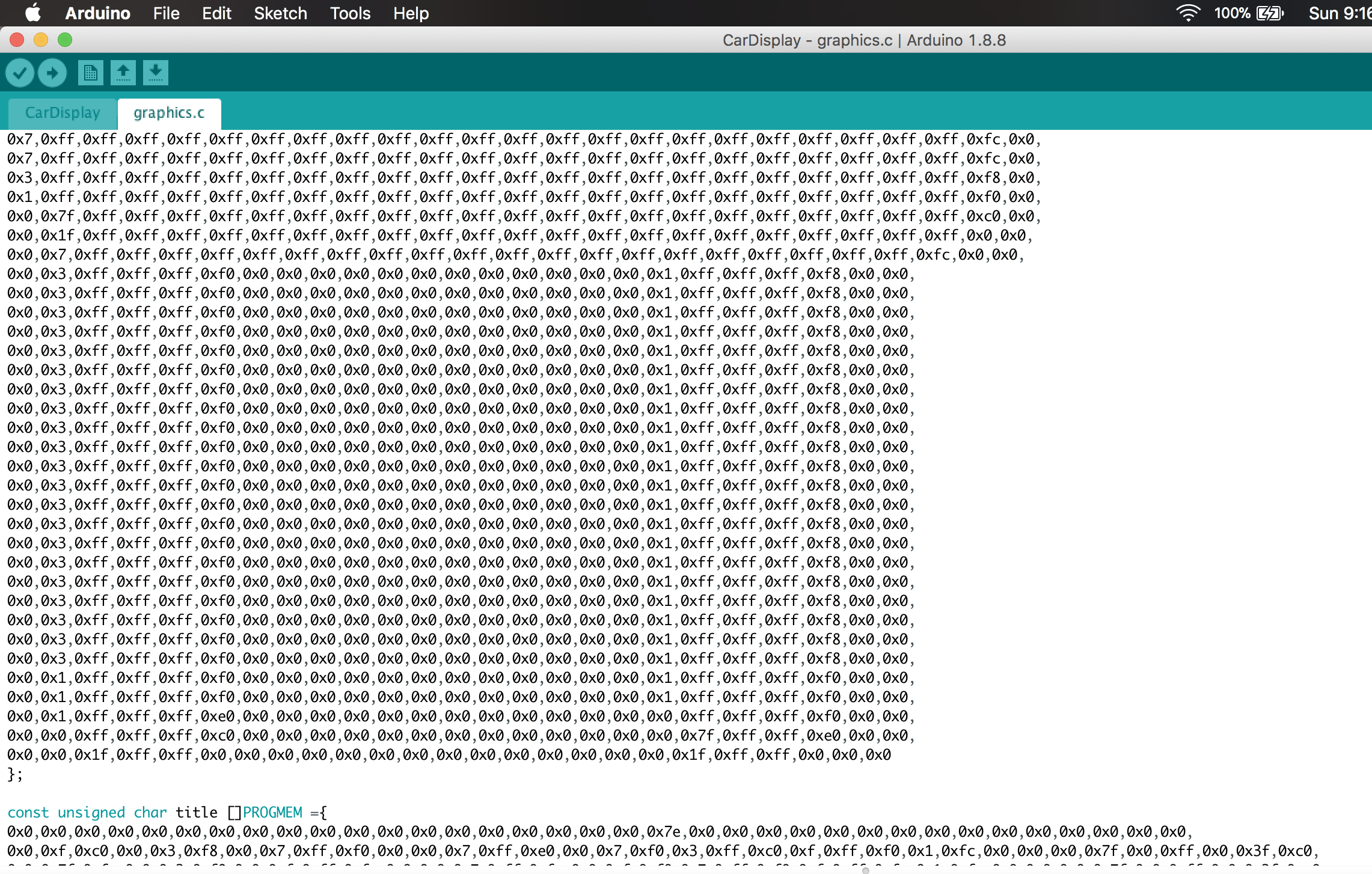

Copy the generated bit array, and create a graphics.c file in the same Arduino project folder where the code will reside.
Ensure the File is in the Same Directory as your main code
Paste the bit array in the graphics.c file and save. Since we have two graphics (the car and the text), You can paste their data array in the same file. check the graphics.c file attached to the zip file, under the download section to understand how to do this. Don’t forget to declare the data type as “const unsigned char“, add PROGEM in front of it and include the avr/pgmspace.h header file as shown in the image below.  This instructs the code to store the graphics data in the program memory of the Arduino.
Copying the Hex file to the Arduino IDE
