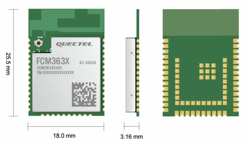

Quectel has introduced a compact and high-performance wireless connectivity module, FCM363X, designed for short-range communication and supporting both Wi-Fi 6 and Bluetooth 5.3. The company emphasizes that this module is tailored for IoT applications, including smart home devices, industrial automation, and embedded systems.

Specifications of Quectel FCM363X Module:
  • Processor: Arm Cortex-M33 processor clocked up to 260 MHz
  • Memory: 1.2MB with PSRAM expansion (optional) up to 8MB
  • Storage: 8MB flash
  • Wireless protocols: IEEE 802.11a/b/g/n/ac/ax and Bluetooth 5.3
  • Wi-Fi frequency bands: 2.4GHz and 5GHz
  • Wi-Fi modulation mode: DSSS/OFDM/DBPSK/DQPSK/CCK/BPSK/QPSK/16QAM/64QAM/256QAM
  • Encryption mode: WPA-PSK/WPA2-PSK/WPA3-SAE/AES-128
  • Interfaces: GPIO, SDIO, USB, UART, SPI, I2C, I2S, ADC, LCD, and PWM
  • Dimensions: 25.5×18.0x3.16 mm
  • Weight: 1.51 grams
  • Operating temperature: -40°C to +85°C
