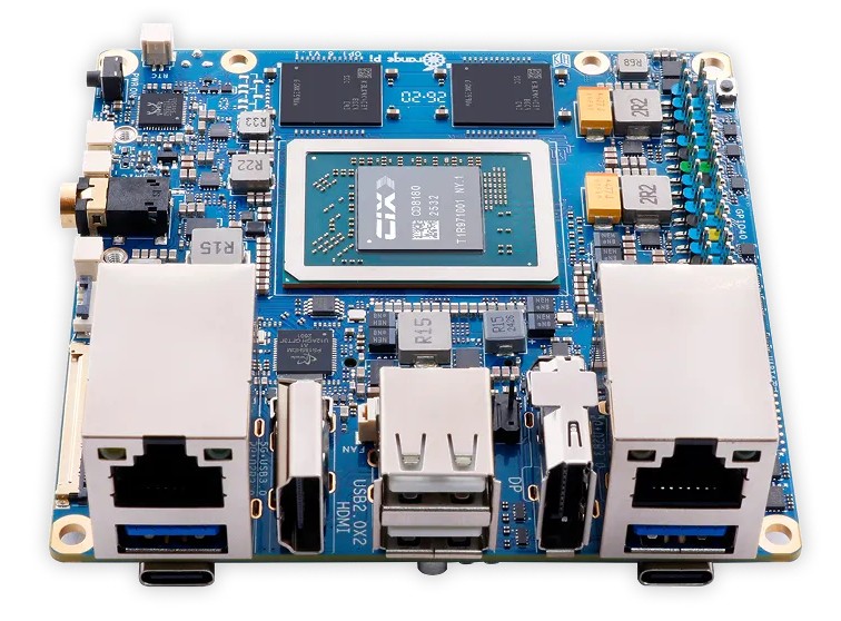

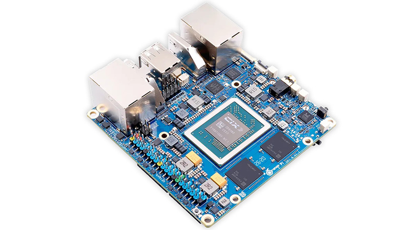

OrangePi has introduced the Orange Pi 6 SBC, a compact edge AI development board powered by the CIX P1 (CD8180) 12-core Arm processor. Designed for AI inference, industrial automation, robotics, home servers, and intelligent edge computing, the board combines high CPU performance with a dedicated NPU and integrated GPU in a compact 90 × 90 mm form factor.
The Orange Pi 6 SBC delivers up to 45 TOPS of combined AI computing power from its CPU, GPU, and NPU, while the NPU alone provides up to 28.8 TOPS for on-device AI workloads. It also supports up to 24GB of LPDDR5 memory running at 6400 MT/s, dual PCIe 4.0 x4 NVMe SSD slots, dual 2.5GbE networking, and multiple display interfaces, making it suitable for demanding edge computing applications.

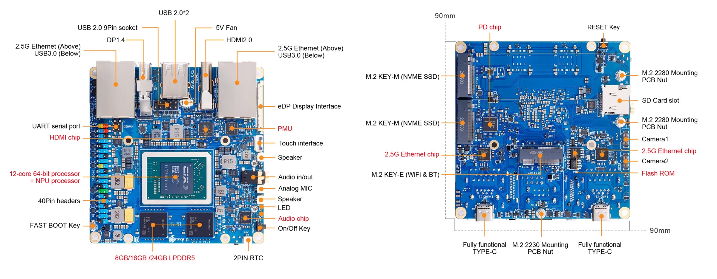

Orange Pi 6 SBC specifications:
  • SoC: CIX P1 (CD8180)
    • 12-core Armv9 CPU with 4x Cortex-A720 cores @ up to 2.6GHz, 4x Cortex-A720 cores @ up to 2.4GHz, and 4x Cortex-A520 cores @ up to 1.8GHz
    • 12MB shared L3 cache
    • 28.8 TOPS NPU with INT4, INT8, INT16, FP16, BF16, and TF32 support
    • Arm Immortalis-G720 MC10 GPU with hardware ray tracing, Vulkan 1.3, OpenGL ES 3.2, and OpenCL 3.0
    • Up to 45 TOPS AI performance (CPU + GPU + NPU)
  • System memory: 8GB, 16GB, or 24GB 128-bit LPDDR5 memory up to 6400 MT/s
  • Storage:
    • 64Mbit SPI flash
    • 2x M.2 Key-M 2280 (PCIe 4.0 x4) slots for NVMe SSDs
    • microSD card slot
  • Display output:
    • 1x DisplayPort 1.4 (up to 4K@120Hz)
    • 1x HDMI 2.0 (up to 4K@60Hz)
    • 2x USB Type-C with DisplayPort Alt Mode (up to 4K@60Hz)
    • 1x eDP interface (up to 4K@60Hz)
  • Camera: 2x 4-lane MIPI CSI interfaces
  • Networking:
    • 2x 2.5GbE RJ45 Ethernet ports
    • M.2 Key-E socket for optional Wi-Fi 6 and Bluetooth 5.4 module
  • USB:
    • 2x USB 3.2 Gen 2 Type-A ports
    • 2x USB 2.0 Type-A ports
    • 2x USB Type-C 3.2 Gen 2 ports with DisplayPort Alt Mode and USB Power Delivery
    • Internal USB 2.0 header
  • Audio:
    • 3.5mm headset jack
    • Dual speaker headers
    • Analog microphone connector
  • Expansion:
    • 40-pin GPIO header with UART, I2C, SPI, and PWM
    • PWM fan header
    • RTC connector
    • UART debug port
  • Misc:
    • Power, Reset, and BOOT buttons
    • Power and system status LEDs
  • Power input: USB Type-C PD (20V), compatible with 65W and 100W power adapters
  • Dimensions: 90 × 90 mm
  • Weight: 106 g
