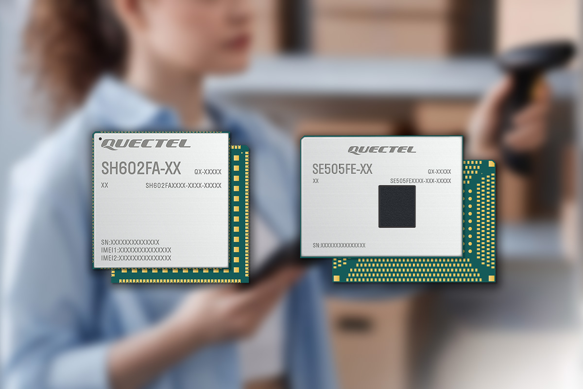

Quectel, an IoT specialist, recently unveiled two newly developed cellular “smart modules,” one for 4G LTE high-end cellular gadgets and another aimed for entry-level 5G NR designs. Both the SH602FA and SE505FE support Google’s Android 16 operating system. The SH602FA 4G LTE Cat 4 and SE505FE 5G Sub-6 GHz Android 16-smart IoT hardware modules feature octa-core MediaTek processors, cellular networking, standardized wireless interfaces and advanced multimedia features for smart displays, point-of-sale terminals, industrial handhelds and robots.
The “high-performance” 4G LTE SH602FA module is based on the MediaTek MT8786 Cortex-A75/A55 processor, and the “entry-level” 5G SE505FE module is powered by a MediaTek MT8863T Cortex-A76/A55 SoC. Both configurations are available in a number of localized versions and a Wi-Fi/Bluetooth-only “-WF” variant.

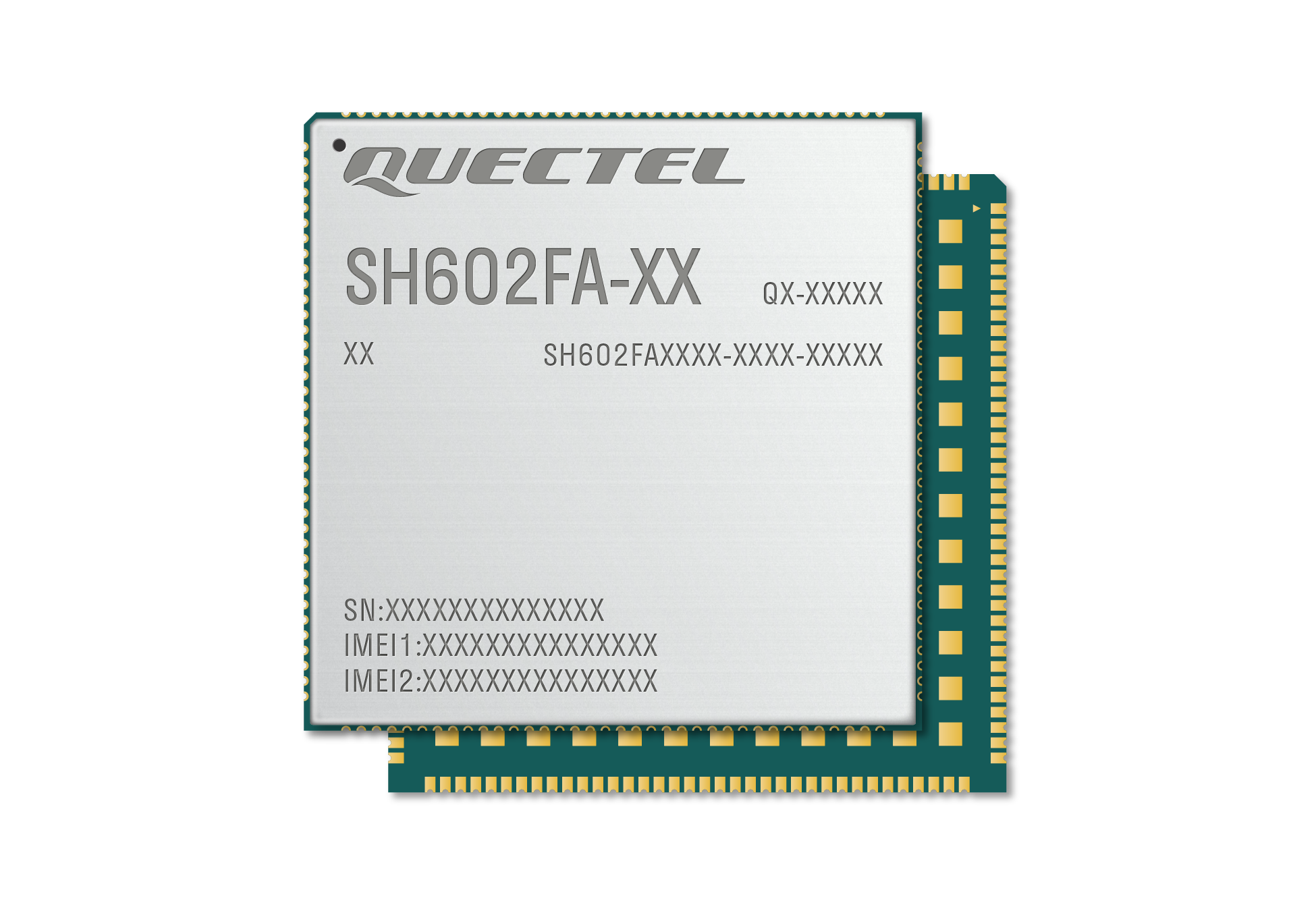

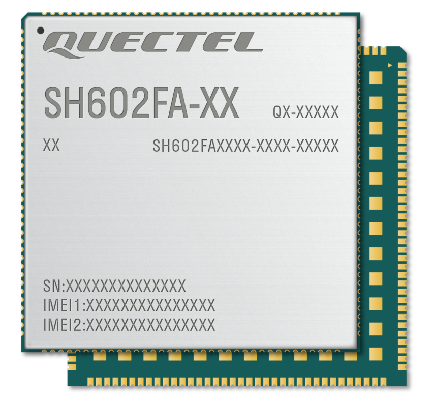

Quectel SH602FA:
Quectel SH602FA
LTE SH602FA smart module series
Key Specifications:
  • Processor: MediaTek MT8786 octa-core SoC with 2× Cortex-A75 cores at 2.0 GHz and 6× Cortex-A55 cores at 1.8 GHz
  • GPU: ARM Mali-G52 2EEMC2
  • Memory: 4 GB LPDDR4X, with 2 GB option
  • Storage: 64 GB eMMC, with 32 GB option
  • Cellular: 4G LTE Cat 4, 3G WCDMA, and 2G GSM
  • LTE Speed: Up to 150 Mbps downlink and 50 Mbps uplink
  • Wireless: Dual-band Wi-Fi 5 and Bluetooth 5.0
  • GNSS: GPS, GLONASS, BDS, Galileo, and QZSS
  • Display: 4-lane MIPI-DSI supporting FHD+ at 60 fps
  • Camera: 2× 4-lane + 1× 1-lane MIPI-CSI; up to 25 MP @ 30 fps
  • USB: USB 2.0 with OTG
  • I/O: 47 GPIOs, 2 UARTs, 8 I²C, 6 SPI, 2 I²S, and 1 ADC
  • Package: LCC

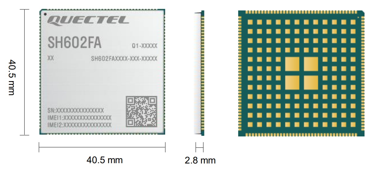

  • Dimensions: 40.5 × 40.5 × 2.8 mm
  • Weight: 10.39 g
  • Operating Temperature: −35°C to +75°C
Quectel SH602FA Specifications
Quectel SH602FA Dimensions

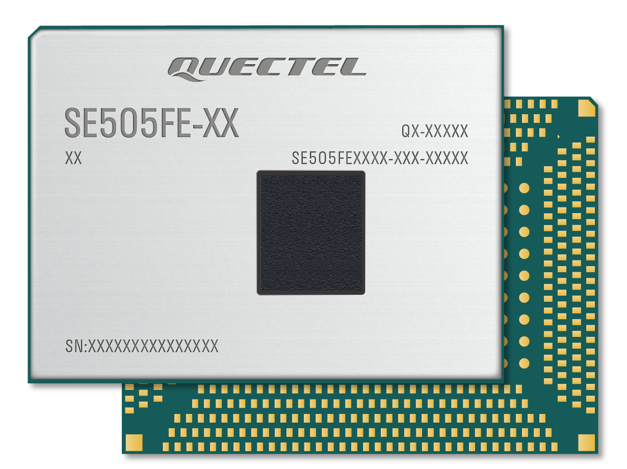

Quectel SE505FE:
5G SE505FE smart module series
Key Specifications:
  • Processor: MediaTek MT8863T octa-core SoC with 2× Cortex-A76 cores at 2.4 GHz and 6× Cortex-A55 cores at 2.0 GHz
  • GPU: IMG GE8300 at 660 MHz
  • Cellular: 5G Sub-6 GHz, 4G LTE, and 3G WCDMA
  • 5G Speed: Up to 3.27 Gbps downlink and 1.25 Gbps uplink
  • MIMO: 4×4 downlink MIMO
  • Wireless: Bluetooth 5.2
  • Display: 4-lane MIPI-DSI with FHD+ resolution at up to 120 fps
  • Camera: 3× 4-lane MIPI-CSI; up to 32 MP @ 30 fps or dual 16 MP @ 30 fps
  • USB: USB 3.1 with USB 2.0 backward compatibility
  • I/O: 181 GPIOs, 2 UARTs, 9 I²C, 2 SPI, 2 I²S, and 5 ADCs
  • Antenna Interfaces: 5× cellular, 1× GNSS, and 1× Wi-Fi/Bluetooth
  • Package: LGA

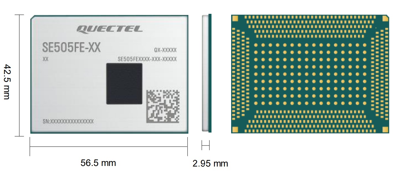

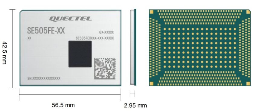

  • Dimensions: 42.5 × 56.5 × 2.95 mm
  • Weight: Not specified
Quectel SE505FE Specifications
Quectel SE505FE Dimensions
