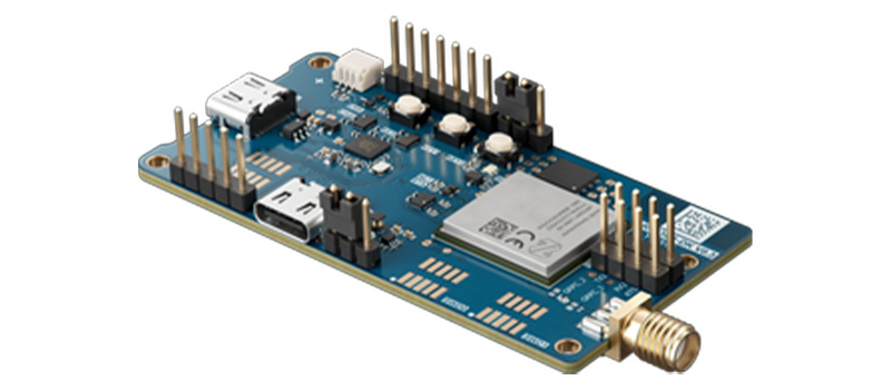

nRF93M1 Development Kit
The nRF93M1 Development Kit (DK) is a product created to assist developers in evaluating and prototyping apps with the nRF93M1 LTE Cat-1 bis Cellular module. The kit features the nRF93M1 device and other peripherals and interfaces to enable engineers to quickly test connectivity over cellular, as well as create IoT prototypes without creating their own hardware.
The nRF93M1 is responsible for providing cellular communication, whereas the nRF54L15 ultra-low-power microcontroller is the host MCU to execute user applications in the development kit. It is compatible with the Nordic nRF Connect SDK, which allows developers to create firmware and test network connectivity and cloud services to manage their devices and apply firmware over-the-air updates.
At the time of writing, the NRF93M1 cellular IoT module and the nRF93M1 Development Kit of Nordic Semiconductor are already lead-customer sampling available, and are widely expected to be more broadly available in mid-2026 via Nordic and their distributors. The company is not yet stating actual prices, and any interested developers should address Nordic Semiconductor or resellers in order to obtain evaluation samples and price information. You can visit the press release for more information.
