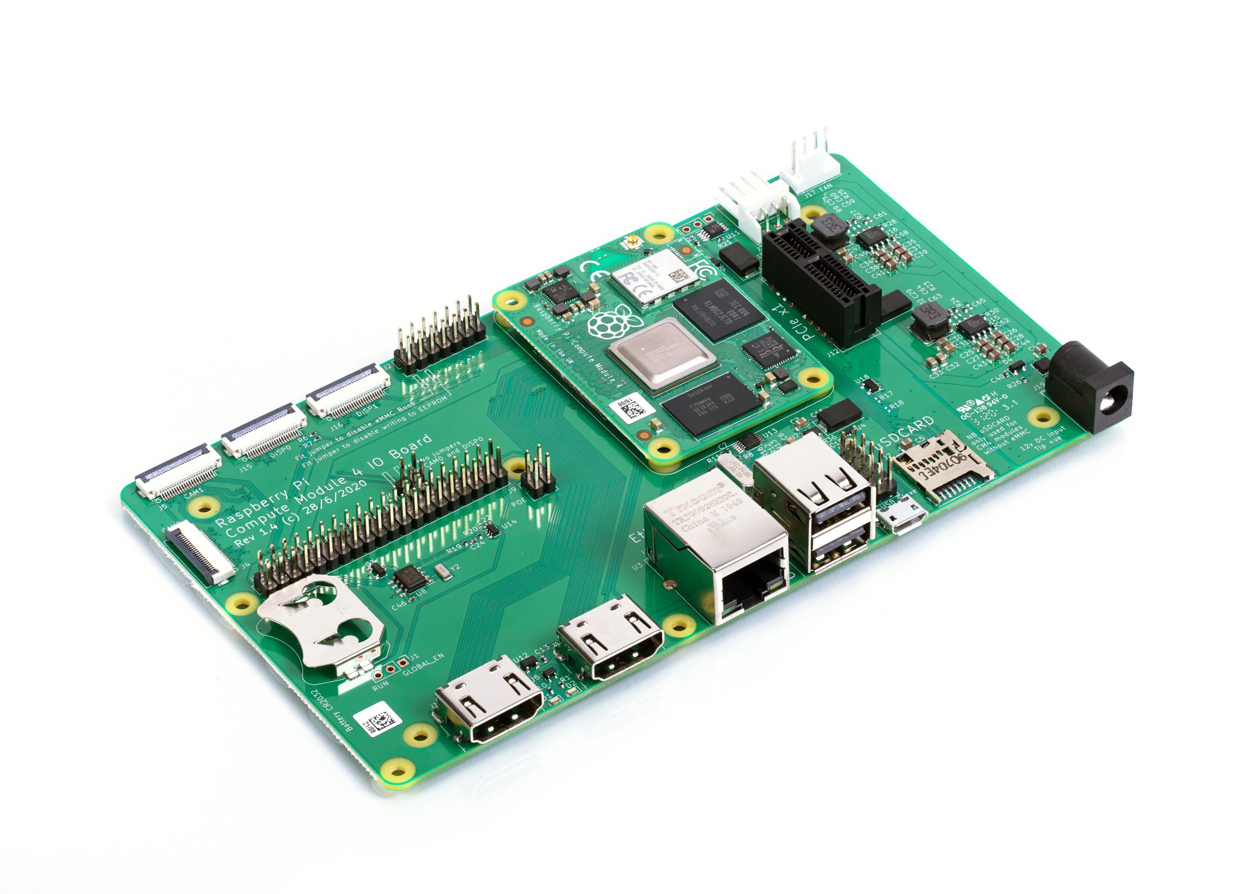

Compute Module 4 IO Board
Raspberry Pi Foundation is also launching an updated IO Board to help you get started with the Compute Module 4. Like the IO boards for earlier Compute Module products, this breaks out all the interfaces from the Compute Module to standard connectors, providing a ready-made development platform and a starting point for your own designs. The IO board features two full-size HDMI port, Gigabit Ethernet jack, two USB 2.0 ports, and MicroSD card socket (only for use with Lite, no-eMMC Compute Module 4 variants). It also enables x1 socket PCI Express Gen 2, HAT footprint with 40-pin GPIO connector and PoE header, 12V input via barrel jack (supports up to 26V if PCIe unused), Camera and display FPC connectors, and Real-time clock with battery backup. CAD for the IO board is available in KiCad format.

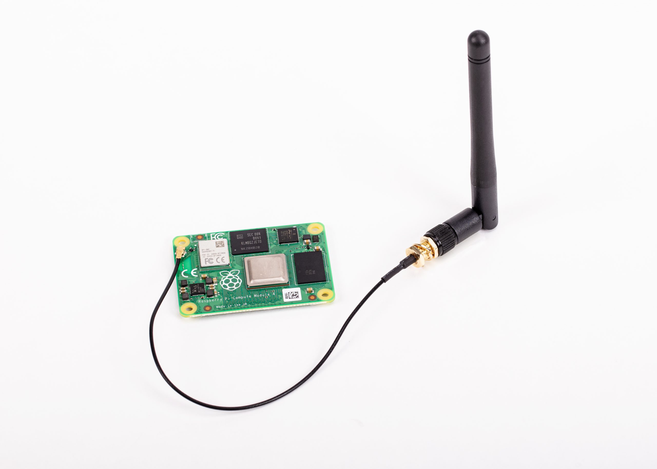

Antenna Kit and Compute Module 4
Available also is an optional, $5 Compute Module 4 Antenna Kit for situations where there’s a metal case that might block the internal antenna, or where it is not possible to provide the necessary ground plane cut-out under the module. The kit comes with a whip antenna with a bulkhead screw fixture and a U.FL connector. The highlight of the spec list includes:
